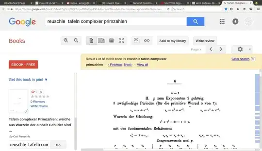

Added, Saturday: Gauss initiated the study of cyclotomic, umm, numbers, and a simple method for creating polynomials for which they were roots. This is discussed in modern terminology HERE. The jpeg at the bottom is from an 1875 book by Reuschle, with many, many such calculations. I put a list of such cubics with prime denominator at http://math.stackexchange.com/questions/2022216/on-the-trigonometric-roots-of-a-cubic/2022887#2022887 With prime denominator, the cubic is $x^3 + x^2 - \left( \frac{p-1}{3} \right) x + c$ with an integer $c.$ For denominator $9$ it is $x^3 - 3 x + 1$ instead, page 174 in Reuschle.
ORIGINAL. umm. The roots of $$ x^3 + x^2 - 2 x - 1 $$ are $$ 2 \cos \frac{2\pi}{7} \; , \; \; 2 \cos \frac{4\pi}{7} \; , \; \; 2 \cos \frac{6\pi}{7} \; . \; \; $$ Taking $$ x = -2t $$ gives $$ -8t^3 + 4 t^2 + 4 t - 1 $$
