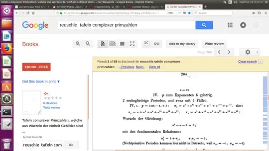

Here is the way the conclusion is given in Reuschle (1875) page 204. The main variables are $\omega$ and $\varpi \; \; ,$ which Latex calls varpi.
ORIGINAL: Alright, multiply $ y^3 + y^2 - 7 y - 10 $ by $x^{15}$ and reduce by the degree 12 polynomial, it comes out to $$ 9 + 9 x + 10 x^2 + 9 x^3 + 10 x^4 + 10 x^5 + 9 x^6 + 10 x^7 + 9 x^8 + 9 x^9 + 10 x^{10} + 10 x^{11} + 9 x^{12} + 10 x^{13} + 10 x^{14} + 8 x^{15} + 10 x^{16} + + 10 x^{17} + 9 x^{18} + 10 x^{19} + 10 x^{20} \; \; . $$ This is, however, $$ \left( 9 + 18 x + 28 x^2 + 28 x^3 + 29 x^4 + 29 x^5 + 29 x^6 + 20 x^7 + 10 x^8 \right) \left(x^{12} - x^{11} + x^9 - x^8 + x^6 - x^4 + x^3 - x + 1 \right) $$ and is actually zero.

  • I guess that explains why $\eta^3 + \eta^2 - 7 \eta - 10$ is not in Reuschle, instead double this $x_0$ is listed as solving $\omega^2 - \omega - 5.$ Page 204 https://books.google.com/books?id=wt7lgfeYqMQC&pg=PR1&lpg=PR1&dq=reuschle++tafeln+complexer+primzahlen&source=bl&ots=VGZFPrfUBn&sig=MlQ667PqXaQ9rAvLWkG3_F1rwsk&hl=en&sa=X&ved=0ahUKEwiIwtSvm9TQAhUJ-2MKHXJIA_kQ6AEIODAE#v=onepage&q=reuschle%20%20tafeln%20complexer%20primzahlen&f=false – Will Jagy Mar 28 '18 at 04:42
