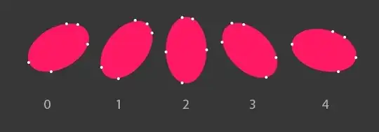

I need to get the correct angle of rotation of the ellipses. These ellipses are examples. I have a canonical coefficients of the equation of the five points.
$$Ax ^ 2 + Bxy + Cy ^ 2 + Dx + Ey + F = 0$$
Ellipses:
Points:
Zero ellipse:   [16,46]  [44,19]  [50,35]  [31,61]  [17,54]
First ellipse:  [14,95]  [47,71]  [55,83]  [23,107] [16,103]
Second ellipse: [12,128] [36,117] [58,128] [35,146] [13,136]
Third ellipse:  [16,164] [29,157] [54,188] [40,195] [17,172]
Fourth ellipse: [22,236] [31,207] [50,240] [40,252] [26,244]
Coefficients:

I successfully find the coordinates of the center and the length of the axes. But I get the wrong rotation.
I get the angle using the equation: $$\theta = \frac{1}{2} \arctan \left( \frac{B}{A-C} \right) $$
Angles result:
Zero ellipse:    0.4766612094205555
First ellipse:  -0.6500786401646479
Second ellipse:  0.03921024408607312
Third ellipse:  -0.7568233305427435
Fourth ellipse: -0.24572750447422026

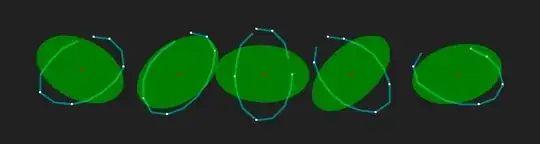

Visualization of the result:
How do I calculate the correct angle? And how to convert the value to degrees without errors?

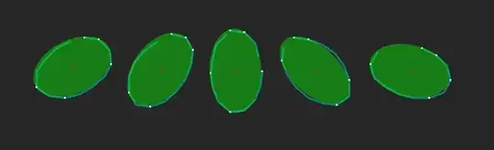

UPDATED: SOLVED!
Based on the response of @Ng Chung Tak, I managed to get into the code and implement the right formula!
Implementation of the code here.
Formula:
$$\theta = \tan^{-1} \left( \frac{C-A}{B}+\frac{\sqrt{(A-C)^{2}+B^{2}}}{B} \: \right) $$
Result:
Thanks to all!

  • Wouldn't it be $\theta = \arctan \left( \frac{B}{A-C} \right)$ without the $\frac{1}{2}$ due to the fact that the coefficient of $xy$ is $B$ instead $2B$ ? – Jean Marie Jun 25 '16 at 18:59
  • @JeanMarie, this equation gave me here http://math.stackexchange.com/q/1824974 – Qulery Jun 25 '16 at 19:02
  • @JeanMarie, without $1/2$ I get the following result: https://swinechat.com/other/image_3.jpg – Qulery Jun 25 '16 at 19:07
  • I was wrong. Sorry for that. But now I see another reason: I think that you are not doing the rotation around the center of the ellipse but around the origin of the axes. – Jean Marie Jun 25 '16 at 19:15
  • @JeanMarie, I make rotation about the red point (center) – Qulery Jun 25 '16 at 19:24
  • But do you have the following three steps : - one for driving the ellipse center onto the origin - one for making the rotation - one for sending back the origin onto the center of the ellipse ? – Jean Marie Jun 25 '16 at 19:29
  • @JeanMarie, For visualization of ellipses, I use the standard method of canvas. I do calculations on the link above. https://developer.mozilla.org/ru/docs/Web/API/CanvasRenderingContext2D/ellipse
    Do you have any idea how to write an equation?
    – Qulery Jun 25 '16 at 19:36
  • In case it helps: Multiply by $180/\pi \approx 57.295779513$ to convert radians to degrees. (Your arctangents appear to be in radians, which is expected if you're using standard math libraries.) – Andrew D. Hwang Jun 25 '16 at 20:18
  • @AndrewD.Hwang, thank you, but it does not solve the problem. https://swinechat.com/other/image_4.jpg – Qulery Jun 25 '16 at 20:29
There're two principal axes in general, so
\begin{align*} \theta &=\frac{1}{2} \tan^{-1} \frac{B}{A-C}+\frac{n\pi}{2} \\ &= \tan^{-1} \left( \frac{C-A}{B} \color{red}{\pm} \frac{\sqrt{(A-C)^{2}+B^{2}}}{B} \: \right) \\ \end{align*}
The centre is given by $$(h,k)= \left( \frac{2CD-BE}{B^2-4AC}, \frac{2AE-BD}{B^2-4AC} \right)$$
Transforming to $$\frac{A+C \color{red}{\pm} \sqrt{(A-C)^{2}+B^{2}}}{2} x'^2+ \frac{A+C \color{red}{\mp} \sqrt{(A-C)^{2}+B^{2}}}{2} y'^2+ \frac {\det \begin{pmatrix} A & \frac{B}{2} & \frac{D}{2} \\ \frac{B}{2} & C & \frac{E}{2} \\ \frac{D}{2} & \frac{E}{2} & F \end{pmatrix}} {\det \begin{pmatrix} A & \frac{B}{2} \\ \frac{B}{2} & C \\ \end{pmatrix}}=0$$
where $\begin{pmatrix} x' \\ y' \end{pmatrix}= \begin{pmatrix} \cos \theta & \sin \theta \\ -\sin \theta & \cos \theta \end{pmatrix} \begin{pmatrix} x-h \\ y-k \end{pmatrix}$.
The axes will match, up to reflection about the axes of symmetry, when the $\color{red}{\text{case}}$ (upper or lower) agrees.

$$\theta = \tan^{-1} \left( \frac{C-A}{B}+\frac{\sqrt{(A-C)^{2}+B^{2}}}{B} \: \right) = \tan^{-1} \left( -\frac{\sqrt{5}+1}{2} \right) \approx -58.28^{\circ} $$
\begin{align*} \begin{pmatrix} x \\ y \end{pmatrix} &= \begin{pmatrix} \cos \theta & -\sin \theta \\ \sin \theta & \cos \theta \end{pmatrix} \begin{pmatrix} x' \\ y' \end{pmatrix}+ \begin{pmatrix} h \\ k \end{pmatrix} \\ &&\\ &= \begin{pmatrix} h+x'\cos \theta-y'\sin \theta \\ k+x'\sin \theta+y'\cos \theta \end{pmatrix} \\ &&\\ &= \begin{pmatrix} \sqrt{\frac{5}{2}+\sqrt{5}\,} \, \sin t+ \sqrt{\frac{5}{2}-\sqrt{5}\,} \, \cos t \\ -\frac{1}{2}+ \frac{\sqrt{5+\sqrt{5}}}{2} \, \sin t- \frac{\sqrt{5-\sqrt{5}}}{2} \, \cos t \end{pmatrix} \end{align*}
Ng Chung Tak
  • 19,693
  • On the basis of your formula, I received the following values. How can I apply them to produce correct angle? https://swinechat.com/other/image_7.jpg – Qulery Jun 26 '16 at 11:22
  • Rearrange your transformed ellipse as $\displaystyle \left( \frac{x'}{a} \right)^2+\left( \frac{y'}{b} \right)^2=1$, then $(x',y')=( a\cos t, b\sin t)$, now do the inverse transform $\begin{pmatrix} x \ y \end{pmatrix} = \begin{pmatrix} \cos \theta & -\sin \theta \ \sin \theta & \cos \theta \end{pmatrix} \begin{pmatrix} x' \ y' \end{pmatrix} +\begin{pmatrix} h \ k \end{pmatrix}$ – Ng Chung Tak Jun 26 '16 at 15:12
  • Please write in the answer the call sequence of formulas that I can integrate into my code, to get the correct angle of the ellipse – Qulery Jun 26 '16 at 15:38
  • I only familiar with Mathematica or Geogebra, is it OK for you? – Ng Chung Tak Jun 26 '16 at 15:50
  • Yes. I need help to get the formula that I can use to get the right angle. You have written a lot of formulas and I do not understand how to properly and in what order to use them, that would get an angle on the basis of the coefficients after approximation. – Qulery Jun 26 '16 at 15:55
  • Have you learnt any linear algebra before? – Ng Chung Tak Jun 26 '16 at 16:01
  • Yes, but that was long ago – Qulery Jun 26 '16 at 16:04
  • Thank you! Thanks to your answer I have been able to get the right angle! – Qulery Jun 26 '16 at 18:24
