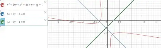

Then with the eigenvalues i found the two lines passing through the center: $$4x-4y-1=0$$ $$8x+8y+3=0$$

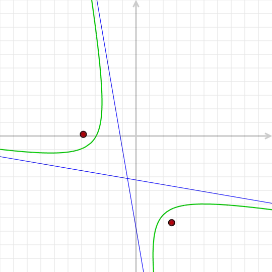

Figure
MvG

For the foci, we can use the fact that the eccentricity of a hyperbola is $e=\sqrt{1+b^2/a^2}=\sqrt{1-\lambda_2/\lambda_1}$ and that the distance from the center to the focus is $f=ea$. For this hyperbola, we have $$e=\sqrt{1+\frac24}=\frac{\sqrt6}2 \\ a^2=-{|A'|\over\lambda_2|A|}=-{-9/4\over(-2)(-8)}=\frac9{64}$$ so $$f=\frac{\sqrt6}2\cdot\frac38={3\sqrt6\over16}$$ which means that the foci are at $$\left(-\frac1{16},-\frac5{16}\right)\pm{3\sqrt6\over16}\left(\frac1{\sqrt2},-\frac1{\sqrt2}\right),$$ approximately $(0.262,-0.637)$ and $(-0.387,0.012)$.
