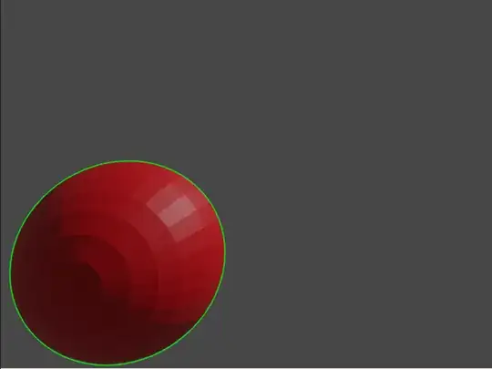

Example of projecting a red sphere into an ellipse and then drawing the ellipse in green:
angle = math.atan2(-B, C - A + root). Otherwise it gives the angle along the short axis. – John Smith May 25 '23 at 15:59
