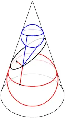

We can always find the unique pair of Dandelin spheres from the conic section without ambiguity.
$\hspace{5cm}$enter image description here
Each Dandelin sphere touches both the right circular cone and the conic section on the corresponding focus.
See also detail discussion with animation in the link here and another post of mine about focal conics and confocal quadrics here.
