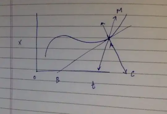

I have just started studying calculus for the first time, and here I see something called a tangent. They say, a tangent is a line that cuts a curve at exactly one point. But there are a lot of lines that can cut the same point just like shown in the picture- enter image description here
WHY aren’t we saying that lines M and C are also tangents?
What is the real definition of a tangent line?
“ A tangent line is a line which passes through two infinitesimally close points” Is this definition correct? Thanks!

  • Aaryan, intuitively, (1) it couldn't be simpler. notice your "incorrect" tangent M. it crosses back inside the curve. imagine another "incorrect" tangent, very close to B. very simply, if you *look really close* ("with a magnifying glass") the incorrect tangent would also cross over, like M. that's all there is to it. – Fattie Apr 19 '16 at 13:24
  • Aaryna intuitively (2) it couldn't be simpler. Imagine a curved piece of wood, and you hold a straight edge against it. You're at point "A" let's say. now you twist the straight edge a little, continuing to press against the wood curve. what happens? It is now, obviously, impossible that it can touch at A it will be touching somewhere else along a little from A. As you '"roll" the straight edge along, it's absolutely impossible that it doesn't change angle. (it is "pushed up" by A which is now "higher") At any point "A" it can ONLY be at a certain angle. – Fattie Apr 19 '16 at 13:28
  • if you're at "A" and you say "try to change the angle of the straight edge, but, keep it at 'A'" it's obviously impossible to do that (unless you deform the wood!). it's that simple. – Fattie Apr 19 '16 at 13:29

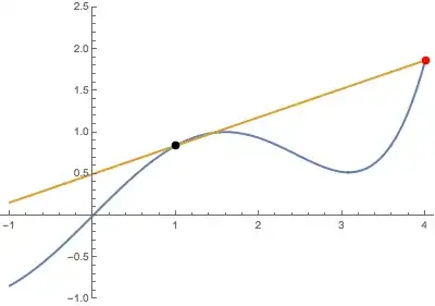

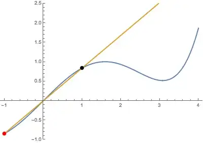

Animations showing that the limit of a secant as the variable point tends towards a fixed point becomes the tangent line.
First, when the variable point (in red) approaches the fixed point (in black) from below:
Second, when the variable point approaches the fixed point from above:
In both cases, the secant line becomes the same tangent line. This suggests that the derivative is well-defined at the black point (which is highlighted in green when tangency occurs).
Formally, then, this gives us a definition of the derivative as follows. For a real-valued function $f(x)$, the derivative at $x = a$ is the limit of the slope of the secant line through two points $$P_a = (a, f(a)), \quad P_b = (b, f(b))$$ as $b$ approaches $a$, whenever such a limit exists. Since the slope is simply $$\frac{f(b)-f(a)}{b-a},$$ we then have $$f'(a) = \lim_{b \to a} \frac{f(b) - f(a)}{b-a}.$$ The equation of the tangent line at the point $P_a$ is therefore $$y - f(a) = f'(a)(x-a),$$ if the line does not have infinite slope; otherwise $1/f'(a) = 0$ and we can write the equation of the tangent line as $x = a$.

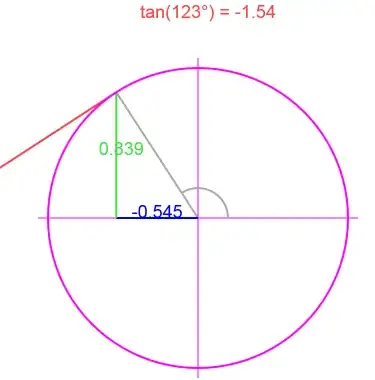

When we talk about a line tangent to a curve we mean a line tangent to the circle corresponding to the radius of curvature. This is because there are only three ways a line can interact with a circle:
  1. The line does not intersect the circle.
  2. The line cuts through the circle, i.e. intersects at two points. We call this a secant line.
  3. The line intersects the circle at one point. This is called the tangent line.
For a smooth curve, at any point we can calculate its curvature with a circle. The line tangent to that circle is the tangent line to the curve.

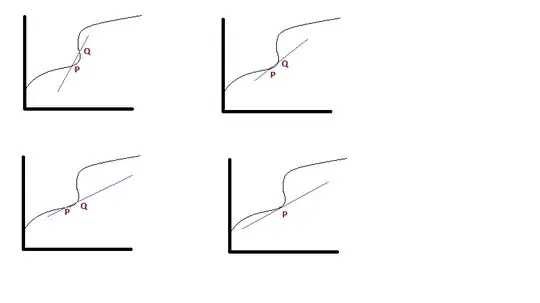

Okay my two cents:
To rigorously define a "tangent" line requires calculus.
Intuitively a tangent line "just" touches and "goes along with" the curve. Your counter examples don't "just touch"-- they hit it head on and go through it. They don't "go along with" the curve-- they intersect it at a significant angle.
But, obviously, that is not a rigorous definition. It's not even close.
If it were up to me I'd define it as a line that touches the curve at a point and at that point the slope of the line (which measures the rate of change of the lines) is the same as the instantaneous rate of change of the curve.
This hints at calculus to come-- namely that "smooth" curves will have instantaneous rates of change and it makes sense to talk of them.
Leibniz defined tangent line as a line through two infinitely close points on a curve, so you are in very good company. However I don't think that works as a definition. There aren't two points that are infinitely close together. There is only one point but the resulting line is the limit of a series of lines made by two points the pairs of which become infinitely closer.
But I do think this concept provides the mechanics of deriving the tangent line and defining the derivative... once the fundamental concepts of calculus (limits and infinitismals) are established.

A tangent attaches between two coincident points $d=0$, a secant attaches between two distinct points with distance $ d>0$. Like skimming and (diving / plunging) they are quite different.
$ M,C$ are not tangents. But $B$ is a tangent .
With respect to rotating arrow lines you drew, $B$ has zero or minimum slope and $C$ has maximum or infinite slope.
Like imagine what you drew was an orange you are cutting with a knife all the orange will be cut for $C$ arrow direction but only a thin 1 inch round circle around tangent cut along $C$ direction.

Tangent is the ratio between the opposite and the adjacent side of a right triangle. If a circle is drawn around the triangle with the diameter of the hypotenuse of the triangle, a line perpendicular to the hypotenuse at the point where it intersects the circle is tangent to the circle, i.e. it passes through one and only one point on the circle. enter image description here
Bérénice
  • 9,487
  • Clearly this isn't the (only) tangent that's being discussed in a calculus course. I think this answer could be improved by noting that this is the motivation for the calculus definition. – pjs36 Apr 19 '16 at 22:52
It might help to look at the definition of a 'secant' line first. A secant line is basically just a line which passes through the graph of a function at two points. To find the tangent line at a specific point (x,y), we look at all of the secant lines containing (x,y). In other words, fix that point and let the second point vary along the curve.
Now, the tangent line is just the limiting line as the second point gets very close to our fixed point (x,y). In most functions, this behaves as others are saying - that is, that the function (close to where we're looking) is all on one side of the tangent line and only our point (x,y) touches the line. There are, however, cases like $x^3$ at (0,0) where the function may split to both sides.

You are operating with the incorrect definition for a tangent. Your statement "They say, a tangent is a line that cuts a curve at exactly one point" is flaw, this is not the definition of a tangent. The correct statement is that a touches a curve at a point and does NOT cross the curve at that point. If a curve is considered to have two sides, a tangent is a line which would approach the curve at a point such that meets the curve but does not cross the curve at that point. There are an infinite number of lines that can cross the curve, but at any point there will only be one which can touch it without crossing it, and this is the tangent at that point.
There is no need to define the tangent in terms of calculus, rather, this definition is the basis for many concepts in calculus, attempting to use calculus to define it would be circular reasoning. Rather, your issue is with an incorrect stating of the definition which could never be reconciled to what a tangent actually is. Note also, this does not mean that the tangent cannot cross the curve, it can, and often does for complex curves. It simply cannot cross the curve at the tangent point.
