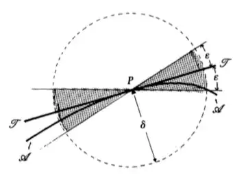

Let $\mathcal A$ be a set of points, let $P$ belong to $\mathcal A$, and let $\mathcal T$ be a line through $P$. Then $\mathcal T$ is a tangent-line to $\mathcal A$ at $P$ if the following condition is satisfied. If $\epsilon$ is any positive number, there is a positive $\delta$ such that every secant $PX$ for which the distance of $X$ from $P$ is less than $\delta$ makes an angle smaller than $\epsilon$ with $\mathcal T$.
This is Hugh Thurston's answer (in his article On Tangents). Note that this definition is with respect to "a set of points" and not to a "curve". Thurston states that there are two reasons for this. The first is that there is no universally accepted definition of curve. A definition that was in favor for a long time is that a curve is the path of a continuously moving point. After Peano showed that such a curve can completely fill a square, attempts were made to modify the definition, none winning 100% acceptance. Luckily the most interesting curves for the study of tangents are simple arcs, about whose definition there is no controversy. The second reason for not confining our attention to curves is to include tangent lines to graphs of functions. Curves and graphs are by no means the same thing, even in a plane. A circle is a curve, but is not the graph of a function, and on the other hand, the graph of the Dirichlet function is not a curve.
In his work, Thurston also makes a brief but illustrative historical review of the "geometric" concept of the tangent line and discusses other problems related to the existence of tangent lines and their intimate relationship with the concept of derivative.
