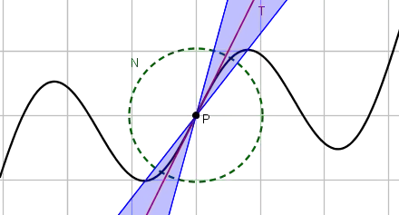

For a more purely geometrical notion of what a tangent is, I imagine a line $T$ through a point $P$ on a curve such that for any given double cone (however thin) with $T$ as its axis and $P$ as its apex point, there is a small enough neighborhood $N$ of $P$ such that the part of the curve within that neighborhood is completely contained in that double cone. Then $T$ is tangent to the curve at $P$.
This definition mimics the idea that the tangent is a linear approximation to and resembles the curve in small neighborhoods of the point.

  • What about the case of a straight line ? –  Oct 26 '15 at 10:34
    @YvesDaoust: This definition renders a line its own tangent. For any other line through $P$ there exist a double cone so thin that the curve/original line only shares the point $P$ with it, thus does not stay within the cone for any ever so small neighborhood. – String Oct 26 '15 at 11:26
  • I know, but is this considered a tangent ? –  Oct 26 '15 at 11:29
  • @YvesDaoust: OK, I see. Both the OP, other answerers, and I seem to converge on precisely that. The only alternative I can think of is to say that a straight line has no tangents, but that makes differentiation of linear functions a strange exception in a way. – String Oct 26 '15 at 12:18
  • Enforcing the condition that there must be a single common point copes with that I think. –  Oct 26 '15 at 13:17
    @YvesDaoust: I prefer that a straight line is its own tangent. I think it makes sense that way. – String Oct 26 '15 at 20:10
