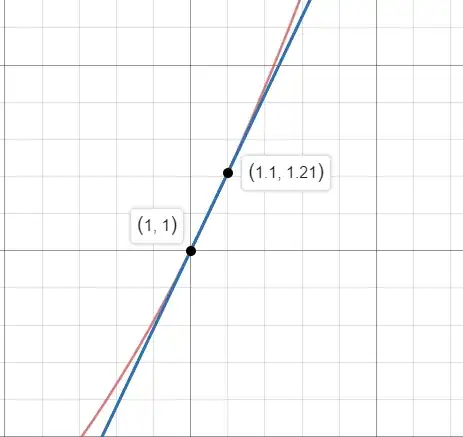

Yes, the above definition is incorrect. More accurately, I would think you'd need to use the following definition instead:
A tangent line is a straight line that touches a function once, locally, at a point.
However, this fails horribly for many functions, hence my second definition:
To me, it fits better in my mind if I think about it as two points, infinitely close, touching the function twice:
As a side note, my second definition transcends into a much better definition of tangent lines for polynomials degree greater than 1 (not linear). If $P(x)$ is a polynomial and $f(x)$ a line, then $f(x)$ is the tangent line of $P(x)$ at $x=a$ if $Q(x)=P(x)-f(x)$ has a root of multiplicity greater than or equal to 2 at $x=a$. (the idea of roots with multiplicities greater than or equal to 2 comes about from the concept "a line that crosses two points infinitely close")
A nice example: Take $P(x)=x^2$ and $f(x)=2x-1$. We see that
$Q(x)=P(x)-f(x)=x^2-2x+1=(x-1)^2$
It has a root of multiplicity two at $x=1$, thus, $f(x)$ is the tangent of $P(x)$ at $x=1$.
