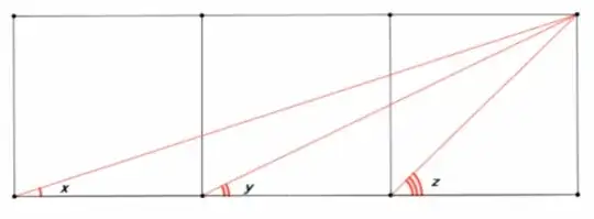

How can I show that $x+y=z$ in the figure without using trigonometry? I have tried to solve it with analytic geometry, but it doesn't work out for me.
- 7,071
- 171
Are all figures in the image intended to be squares? – Edward Jiang Jan 09 '16 at 20:00
Yes! I forgot to mention that. – Hamid Mohammad Jan 09 '16 at 20:01

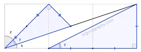

@FlybyNight: Compare the ratios of corresponding sides of $\angle G$ in both triangles. (This is effectively the product relation provided in Batominovski's answer.) – Blue Jan 09 '16 at 23:53

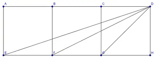

Let $X$, $Y$, and $Z$ be the apexes of the angles $x$, $y$, and $z$, respectively. Also, let $P$ be the common intersection of the red lines. Show that $ZP^2=ZX\cdot ZY$. Thus, the circumcircle of the triangle $PXY$ is tangent to $PZ$ at $P$. This will prove that $\angle YPZ=\angle YXP=x$.
- 50,341
See the last proposition on http://staff.argyll.epsb.ca/jreed/math20p/circles/tangent.htm. – Batominovski Jan 09 '16 at 21:03

@FlybyNight: As a self-styled "trigonographer", I certainly agree that trigonometry is the study of triangle measurements. (It's in the name!) So, sure, if we're being pedantic, a trig-less solution to an angle-sum problem is an impossibility. (In fact, I considered adding a disclaimer to this effect on my answer. :) That said, we reasonably read "without using trigonometry" as OP's hope to avoid sophisticated trigonometric machinery. My sol'n involves trig (as it must), but only at its most-fundamental level: identifying and exploiting similar triangles. sin/cos/tan stuff isn't necessary. – Blue Jan 09 '16 at 23:32
