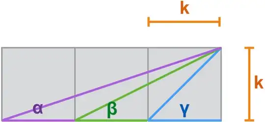

While studying trigonometry, I came across this very interesting problem. It wasn't very difficult to solve, however it's result was quite interesting. I have given the solution below. Try to solve it yourself before looking.
Problem
The diagram below shows three equal squares, with angels $\alpha$, $\beta$, $\gamma$ as marked. Prove that $ \alpha + \beta = \gamma $.
diagram
Hint
If you are not in the midst of a trigonometry course, chances are you will need to see this hint, as it is an uncommon identity.
Hover below to see a hint.
$ \arctan a + \arctan b = \arctan{\frac{a + b}{1 - ab}} $
This identity was solved earlier in the book I found this problem in (see Postscript). Try to prove this identity for yourself, too!
Postscript
This problem came from the textbook: "Trigonometry" by I. M. Gelfand.

Proof
Step 1: Gather information from diagram.
  • $ \alpha = \arctan \frac{1}{3} $
  • $ \beta = \arctan \frac{1}{2} $
  • $ \gamma = \arctan 1 $
Step 2: Add $\alpha$ and $\beta$ and simplify.
$ \alpha + \beta = \arctan \frac{1}{3} + \arctan \frac{1}{2} = $
...Now, using an identity (see hint given in the question)...
$ = \arctan {\frac{\frac{1}{3} + \frac{1}{2}}{1 - \frac{1}{3}\frac{1}{2}}} = \arctan {\frac{\frac{5}{6}}{1 - \frac{1}{6}}} = \arctan {\frac{\frac{5}{6}}{\frac{5}{6}}} = \arctan 1 = \gamma $
Answer
Indeed, $$ \alpha + \beta = \gamma $$
