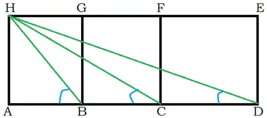

Draw three adjacent squares with same size and any two adjacent square has a common side. This looks like a rectangle. Name all of the vertices of square in anti clock wise from $A$ to $H$. Join $HB$, $HC$, and $HD$. Prove that $$\angle{ABH}+\angle{ACH}+\angle{ADH}=90^\circ$$

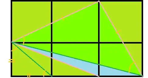

Visual proof of 3-square problem. In this figure we can find three congruence right-angled triangles which are in yellowish-green color and their hands are in ratio $2:1$ and we can see two isosceles right angled triangle. Orange colored angle symbol denote half right angle (i.e,$45^\circ$).
In square $ABGH$, $HB$ is the diagonal of square. By using the property of diagonal of square we get, $\angle{ABH}=45^\circ$. We also know that $\angle{ABH}+\angle{ACH}+\angle{ADH}=90^\circ$.
From above two equations, we get $\angle{ACH}+\angle{ADH}=45^\circ$. $\square$

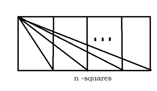

Let $n$ be the number of squares. Is it possible, for $n$-squares, for the sum of all angles which lies below each line to became $180^\circ$?

  • Numerical calculation indicates that if we continue the series with consecutive terms having the form $\arctan(1/n)$ the sum misses 180°. – Oscar Lanzi May 29 '18 at 13:57
    This is easy enough to check with a calculator. For $n=16$, the angle sum is $177.947\ldots^\circ$; for $n=17$, the sum is $181.313\ldots^\circ$. – Blue May 29 '18 at 13:59

The question being asked is whether or not
$$S_n=\sum_{k=1}^n\arctan\left(1\over k\right)$$
is ever equal to $\pi$ (expressed in radians, or $180$, in degrees). By calculation one finds
$$S_{16}\approx3.1057646\lt\pi\lt3.16452042\approx S_{17}$$
so the answer is No. It'd be nice, though, to have a less computationally-dependent answer (along the lines of the proof that $\sum_{k=1}^n{1\over k}$ is never an integer for $n\gt1$).
