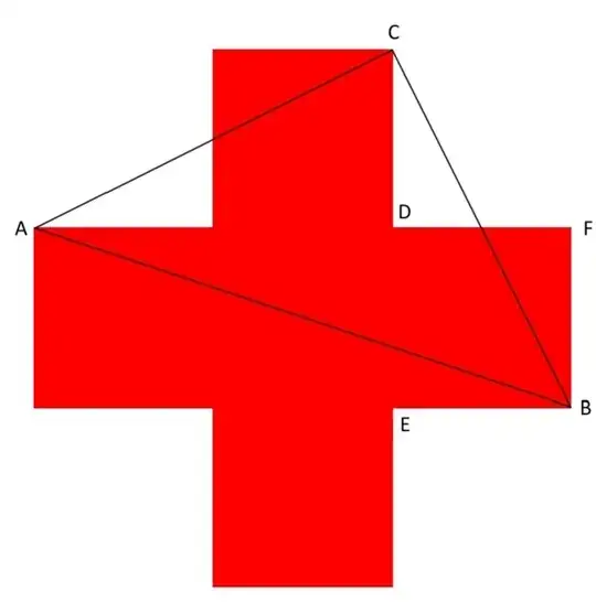

There are many good geometric renderings; my favorite invokes the familiar Red Cross symbol. This symbol consists of a central square block sharing each of its edges with an additional congruent block. We superpose right triangle $ABC$ and label some additional vertices $D,E,F$ as shown below.
$\triangle \space ACD$ and $CBE$ are right triangles with congruent legs, so congruent triangles by SAS; thus their hypotenuses which are also legs of right $\triangle ABC$ are congruent. So the acute angle $BAC$ measures $45°$. But the component of that angle within right $\triangle ACD$ measures $\arctan(1/2)$ and the remaining component within right $\triangle ABF$ measures $\arctan(1/3)$. Thereby $\arctan(1/2)+\arctan(1/3)=45°$.

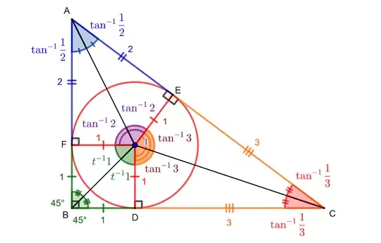

Let us take $\triangle ABC$ with $AB=3, BC=4, CA=5, \angle B = 90^\circ$. Let the angle bisectors $AI, BI, CI$ meet at incenter $I$. From $I$ drop perpendiculars $ID,IE,IF$ onto the sides. The inradius is $ID=IE=IF=1$. Clearly $BFID$ is a square, so $BF=BD=1$, $AF=AE=2$, $CD=CE=3$. This leads to the angles as in the following diagram.
Thus $\frac{A}{2}=\tan^{-1} \frac{1}{2}$, $\frac{C}{2}=\tan^{-1} \frac{1}{3}$. But $A+C=\frac{\pi}{2}$ means $$\frac{A}{2}+\frac{C}{2}=\tan^{-1} \frac{1}{2}+\tan^{-1} \frac{1}{3}=\frac{\pi}{4}$$ As a bonus, adding the six angles formed at the incenter gives $$2\tan^{-1} 1 + 2\tan^{-1} 2 +2\tan^{-1} 3 =2\pi$$ $$\Rightarrow \tan^{-1} 1 + \tan^{-1} 2 +\tan^{-1} 3 =\pi$$
Similar dissections of other right triangles $\{(5,12,13),$ $(7,24,25), \ldots\}$ will give new identities involving $\tan^{-1} (\text{rational number})$.

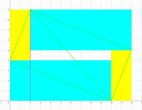

$\bf{Added:}$ With the same method, with some care, we can prove the addition formula for the tangent. Indeed, consider two rectangles with sides, $a$, $b$ , and two with sides $t a$, $t b$. (in the picture below, sides $2,5$ and $4$, $10 $) . Arrange them so we from their diagonals we get a rectangle with the ratio of the sides $t$. Then we get the formula
$$\arctan \frac{a}{b} + \arctan\frac{t b - a}{t a + b} = \arctan t$$
tangent of sums
In our case
$$\arctan\frac{2}{5} + \arctan\frac{8}{9} = \arctan 2$$
Note: If we start from an arbitrary symmetric cross we might not get a rectangle, but only a parallelogram, so we modified the approach a bit. In general, to get a cross that produces a rotated rectangle, start with a container rectangle and intersect its sides with a central circle.

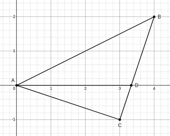

Just to add to the variety of many fine geometrical answers, express the measures of the following three angles in terms of arctangent and compare the results:
$$ \angle CAD, \angle DAB, \angle CAB $$
Equilateral right triangle sides sqrt(10)
