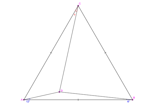

  • $\overset{\Delta}{ABC}$ is an equilateral triangle.
  • D is a point inside triangle.
  • $m(\widehat{BAD})=12^\circ$
  • $m(\widehat{DBA})=6^\circ$
  • $m(\widehat{ACD})=x=?$
I managed to reduce answer to $\cot x=\csc 48^\circ+\sqrt 3$ with the help of Trig-Ceva Theorem, but i can't find x without a calculator. I suspect that there is an elementary (but complex) method to solve this but i'm not sure.
[The answer i'm trying to reach is $18^\circ$]

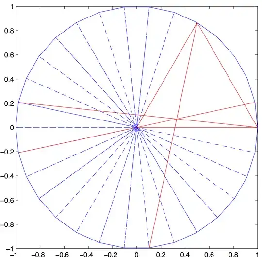

This problem is actually part of a regular $30$-gon, as shown in the following figure. For a proof that three diagonal lines meet at a single point, refer to Section $3$ and Table $4$ (page $13$) of http://www-math.mit.edu/%7Epoonen/papers/ngon.pdf. (Unfortunately, this is not so easy. The following lemma from Section $2$ (pages $4-5$) helps.)
Lemma. Let $A$, $B$, $C$, $D$, $E$, $F$ be six distinct points in order on a circle. The three chords $AD$, $BE$, $CF$ meet at a single point if and only if $AF\cdot BC\cdot DE=CD\cdot EF\cdot AB$.enter image description here

  • Never thought about changing the problem to polygon diagonals. This nice method can generalize really well. However there are some issues: First; i'm stuck at proving product of ratios of adjacent diagonals is $1$. Peter Steinbach's diagonal product formula can easily reduce this issue to showing $d_3+d_5=d_9$, where $d_i$ is $i$th smallest diagonal. Do you know how i prove this result? ... – Alistair Nov 14 '14 at 18:12
  • ... Second; According to Modern geometry; an elementary treatise on the geometry of the triangle and the circle by Roger A. Johnson, your lemma might not be true. According to theorem 228 in page 151, this lemma cannot be used to prove chords are concurrent. I was able to prove concurrent segments imply above relationship easily by Ceva's method, but i'm not sure inverse of this is true, which is needed for solution. Do you know of any proof of this lemma? Where did you encounter this? – Alistair Nov 14 '14 at 18:24
  • This lemma is stated in www-math.mit.edu/~poonen/papers/ngon.pdf (pages 4-5). I'll check if it is really true. – pharmine Nov 14 '14 at 21:42
    A proof of $d_3+d_5=d_9$: it suffices to show $\sin 54^{\circ}-\sin 18^{\circ}=\sin 30^{\circ}$, that is $2\cos 36^{\circ}\sin 18^{\circ}=1/2$. Using the fact that $\alpha=\sin 18^{\circ}$ satisfies $4(1-\alpha^2)-3=2\alpha$ (from $\cos 54^{\circ}=\sin 36^{\circ}$), we can show that $2(1-2\alpha^2)\alpha=1/2$. – pharmine Nov 14 '14 at 22:13
  • I forgot to check the paper in your link while i search the net to find this lemma. By the way, i can't show $4(1-\alpha^2)-3=2\alpha$. How did you find this? I'm asking this just out of curiosity; i already proved $\sin 54^{\circ}-\sin 18^{\circ}=\sin 30^{\circ}$ from another way, so don't worry about proving this whole thing. – Alistair Nov 15 '14 at 08:00
    I used $\cos 3\theta=4\cos^3\theta-3\cos\theta$ and $\sin 2\theta=2\sin\theta\cos\theta$. So $\cos 3\theta=\sin 2\theta$ becomes $\cos\theta(4\cos^2\theta-3)=\cos\theta(2\sin\theta)$, and dividing by $\cos\theta$ (which is not zero) we get $4(1-\sin^2\theta)-3=2\sin\theta$. – pharmine Nov 15 '14 at 10:34
  • It seems it is proven that, chords meet at a single point if and only if $\sin(u/2)\sin(v/2)\sin(w/2)=\sin(x/2)\sin(y/2)\sin(z/2)$ where parameters are arc lengths. I can't seem to show $\sin(u/2)\sin(v/2)\sin(w/2)=\sin(x/2)\sin(y/2)\sin(z/2)$ if and only if non-adjacent products are equal. Maybe if i can relate sine of this arc lengths to something visual in this paper, i get more luck. But i don't even understand where this sines are coming from. – Alistair Nov 17 '14 at 11:55
    It's simple: note that arc length = angle (in radians) when the radius of the circle is 1 (i.e. unit circle). So when the arc length is $u$, the chord length is $2\sin(u/2)$. – pharmine Nov 18 '14 at 05:28
  • Yes. In that case, the lemma stands i believe. I don't see anything wrong with this proof. – Alistair Nov 18 '14 at 09:52

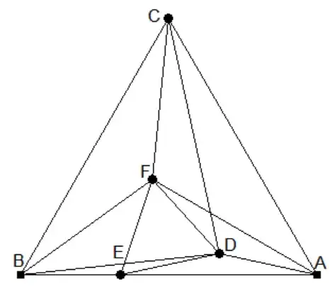

solution
Draw angle bisector of $\widehat{BAD}$, intersecting $[BD]$ in $E$. Draw $[CE]$. Since $\overset{\Delta}{ABE}$ is isosceles, $[CE]$ is the axis of symmetry of $\overset{\Delta}{ABC}$, making $m(\widehat{ECB})=30^\circ$. Draw $[BF]$ such that $m(\widehat{FBD})=6^\circ$ and $|BF|=|AB|$. Draw $[AF]$ and $[CF]$. Since $\overset{\Delta}{BCF}$ is isosceles and $m(\widehat{CBF})=48^\circ$, then $m(\widehat{FCB})=66^\circ$, therefore $m(\widehat{FCA})=6^\circ$. Draw $[DF]$. Since $\overset{\Delta}{ABF}$ is isosceles, $[BD]$ is the axis of symmetry of $\overset{\Delta}{ABF}$, making $m(\widehat{DFB})=12^\circ$. Extend $[AD]$; since $[CE]$ is the axis of symmetry of $\overset{\Delta}{ABC}$ and $m(\widehat{FBA})=m(\widehat{BAD})=12^\circ$, extension of $[AD]$ meet at the intersection of two segments $G$. Since $\widehat{FGA}$ is an exterior angle of $\overset{\Delta}{ABG}$, $m(\widehat{FGA})=24^\circ$. Since $\widehat{FDA}$ is an exterior angle of $\overset{\Delta}{DFG}$, $m(\widehat{FDA})=36^\circ$. Since $m(\widehat{FCG})=36^\circ$ opposite angles of $\overset{\square}{CFDG}$ are supplementary, making this a cyclic quadrilateral, meaning its four points are on a circle. Since $\widehat{FGD}$ and $\widehat{FCD}$ both looking at the same arc in this circle, $m(\widehat{FCD})=24^\circ$. And then, finally, we reach $\alpha=18^\circ$. $\blacksquare$

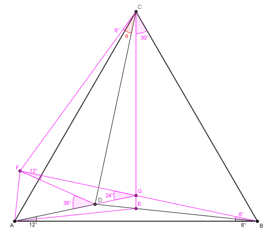

The following proof (for the general problem - $2\widehat{ACD}=3\widehat{BAD}=6\widehat{ABD}=6\alpha$) I saw on a facebook Peruvian group: Take $E$ on $AB|DE=BE=AD$, draw the perpendicular bisector of $BC$, take $F$ on it so that $FD=AB$; clearly $EDF$ is an equilateral triangle, since $D$ is the circumcenter of $\triangle AFE$, and $\widehat{AFD}=\widehat{FAD}=30^\circ-2\alpha$ ( 1 ). $\widehat{AFC}=\widehat{AFB}=120^\circ-\alpha$ ( 2 ), since $\widehat{ABF}=30^\circ+\alpha, \widehat{FAB}=30^\circ$, but also $\widehat{ADC}=120^\circ-\alpha$, since $\widehat{ACD}+\widehat{CAD}=60^\circ+\alpha$, consequently $DACF$ is cyclic and $\widehat{ACD}=\widehat{AFD}$, i.e. $3\alpha=30^\circ-2\alpha$, implying $5\alpha=30^\circ, \alpha=6^\circ$.
For the given problem the proof is slightly different:$\widehat{ACF}=\widehat{ABF}=36^\circ$ ( from symmetry ), while $\widehat{AFB}=\widehat{FAB}=18^\circ$, so $\widehat{ADF}=144^\circ$, again $FDAC$ is cyclic, hence $\widehat{ACD}=\widehat{AFD}=18^\circ$.
