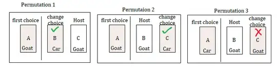

Explanation 1
There are 3 doors. Without loss of generality lets assume that you pick door A.
Now the host will open either door B or C, depending on which has the goat.
You now given the option to change your choice if you want to.
The only reason that we will switch our choice is if we belive the remaining door has the car.
Ask yourself: "what conditions are required that the remaining door is not a car?"
Answer: The only condition that the remaining door is not a car is if both doors are goats. Otherwise, if both doors do not simultaneously have goats behind them then the one door must have a goat and the other a car. Because the host will always open the door with a goat, we know the remaining door must be the car - assuming that both doors do not simultaneously have goats behind them.
Here is the list of all possible permutations:
Thus there is a $\frac{1}{3}$ chance that both doors are goats. Thus this means that there is a $1-\frac{1}{3} = \frac{2}{3}$ chance that the remaining door is correct.
Thus we can conclude that changing our choice gives us a $\frac{2}{3}$ chance of getting the car(winning).
Note: that if there is $\frac{2}{3}$ chance of getting the car(winning) if we change our choice, then there is a $\frac{1}{3}$ of losing. What does it mean if we lose once changing? This means that our first choice was correct, thus there is a $\frac{1}{3}$ chance that our first choice was correct.
Explanation 2
Here is all the permutation given graphically:
From here we can see keeping with our initial choice gives as $\frac{1}{3}$ chance of getting the car(winning), but chaning our choices gives us $\frac{2}{3}$ chance of getting the car(winning).
