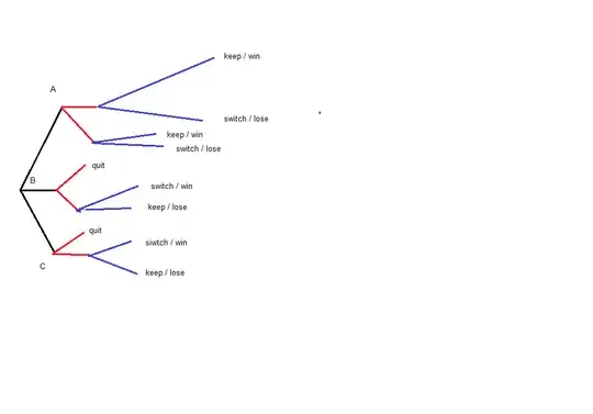

Here is a picture enter image description here
Suppose the car is on card A (you don't know that).
You choose, A,B or C. (the black lines). The host makes the red line choice. You make the final keep or switch choice.
All of the keep/switch choices are equally likely. Half win, half lose.
