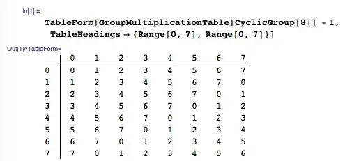

I list computational methods in group theory. The $C_8$ example by Sharma is visualised in Mathematica below. Python one-liners are convenient way to verify generator guesses, in the case of multilpicative group just change one $*$ (multiplication) to $**$ (power).
Python
For example to check that 1 and 5 generate $(\mathbb Z_6,+)$ and all relative prime numbers $\{1,3,5,7\}$ generate $(\mathbb Z_8,+)$
>>> [(1*x)%6 for x in range(20)]
[0, 1, 2, 3, 4, 5, 0, 1, 2, 3, 4, 5, 0, 1, 2, 3, 4, 5, 0, 1]
>>> [(5*x)%6 for x in range(20)]
[0, 5, 4, 3, 2, 1, 0, 5, 4, 3, 2, 1, 0, 5, 4, 3, 2, 1, 0, 5]
>>> [(3*x)%8 for x in range(20)] [0, 3, 6, 1, 4, 7, 2, 5, 0, 3, 6, 1, 4, 7, 2, 5, 0, 3, 6, 1] >>> [(5*x)%8 for x in range(20)] [0, 5, 2, 7, 4, 1, 6, 3, 0, 5, 2, 7, 4, 1, 6, 3, 0, 5, 2, 7] >>> [(7*x)%8 for x in range(20)] [0, 7, 6, 5, 4, 3, 2, 1, 0, 7, 6, 5, 4, 3, 2, 1, 0, 7, 6, 5]
Mathematica (source)
On Sharma's example: the $C_8$ isomorphic to $(\mathbb Z_8,+)$ group visualised below.
