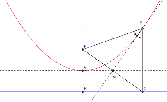

Let $F$ be the focus of the parabola, $HG$ its directrix, with vertex $V$ the midpoint of $FH$. From the definition of parabola it follows that $PF=PG$, where $P$ is any point on the parabola and $G$ its projection on the directrix.
The tangent at $P$ is the angle bisector of $\angle FPG$, hence it is perpendicular to the base $GF$ of isosceles triangle $PFG$, and intersects it at its midpoint $M$.
But the tangent at $V$ is parallel to the directrix and bisects $FH$, hence it also bisects $FG$ at $M$, as it was to be proved.
