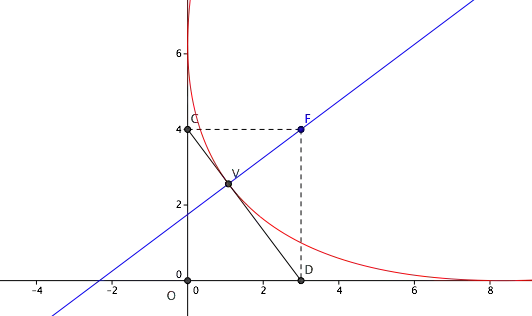

A nice property of the parabola states that: the perpendicular from the focus to any tangent intersects it, and the tangent through the vertex, at the same point.
Hence the tangent at the vertex intersects the axes at $(3,0)$ and $(0,4)$.
