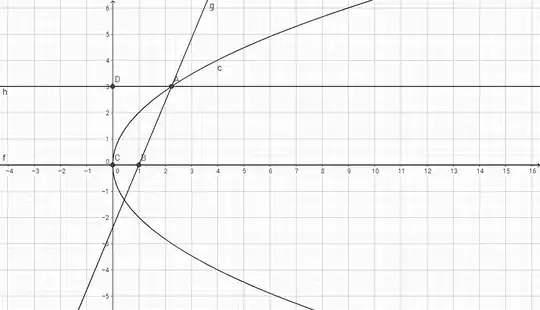

Is there a way to prove the property of the parabola that a ray parallel to its axis of symmetry if "reflected" by the parabola will intersect the symmetry axis of the parabola, without using analytic geometry?
Assuming that $DA\parallel CB$ and that the line has been reflected,I want to prove that B is in fact the focus of the parabola.
  • Idea/Hint: it suffices to show that, if the intersection of the parallel ray with the directrix is $E$, then $\triangle EAB$ is isoceles, and the tangent to the parabola at $A$ either bisects $BE$ or is perpendicular to it (either is sufficient to give two congruent right-angled triangles). – Chappers Aug 12 '17 at 12:34
    There's one at http://jwilson.coe.uga.edu/EMAT6680Fa08/Wisdom/EMAT6690/Parabolanjw/reflectiveproperty.htm , found at https://physics.stackexchange.com/questions/351498/pure-geometry-proof-of-parabolic-mirror-property – Ethan Bolker Aug 12 '17 at 12:37
  • Would you mind a proof that just uses equation of a line ? –  Aug 12 '17 at 13:13
    Undermines the point, man. – Archimedesprinciple Aug 12 '17 at 15:05
Let $F$ be focus of parabola.
It is well known that if we project orthogonal any point $P$ on parabola to it directrix we get such point $P'$ on directrix, that perpendicular bisector $t$ of $FP'$ is tangent of parabola at $P$. Thus if we reflect $PG$ across $t$ we get parallel through $P$ to axis of symmetry of parabola.
So if we reverse this process, we see that if reflect parallel to axis of symmetry at point $P$ on parabola, this reflection must go through $F$.
