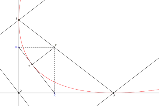

While drawing the diagram, I am getting that the parabola touches $x$ axis at $A(a,0)$ and touches $y$ axis at $(0,b)$
Also, the tangents at points $A$ and $B$ intersect each other at $(0,0)$ at an angle of $90^\circ$.

A nice property of the parabola states that: the perpendicular from the focus to any tangent intersects it, and the tangent through the vertex, at the same point. Hence, if the tangent at vertex $V$ intersect the axes at $A'=(\alpha,0)$ and $B'=(0,\beta)$, then focus $F$ has coordinates $(\alpha,\beta)$.
The axis $FV$ is perpendicular to $A'B'$, hence its slope is $\alpha/\beta$. But the tangent at $A$ forms equal angles with the axis and $FA$, hence the slope of line $FA$ is $-\alpha/\beta$. The same goes for line $FB$, hence we have the equations: $$ {\beta-b\over\alpha}={\beta\over\alpha-a}=-{\alpha\over\beta}, $$ which can be solved to find: $$ \alpha={ab^2\over a^2+b^2},\quad \beta={a^2b\over a^2+b^2}. $$ The directrix is the parallel to $A'B'$ passing through the origin.
