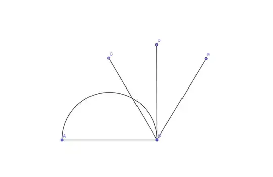

We begin by choosing two points and aligning the $\,x$-axis with them.
Below is a $\,2D\,$ diagram representing points in quadrants $\,1\,$ and $\,2\,$ of a Cartesian plane with $\,B\,$ at the origin. All points $\,E\,$ in quadrant $\,1\,$ can only be used to form obtuse triangles with $\,A\,$ and $\,B.\,$ All points $\,D\,$ along the $\,Y$-axis can only be used to form right triangles. All points $\,C\,$ in quadrant $\,2\,$ will form acute triangles unless $\,C\,$ falls within the semicircle defined by diameter $\,AB\,$ or falls to the left of point $\,A.$
If the plane is finite, and $\,C\,$ is to the right of $\,A,\,$ then the probability is $\,50\%\,$ times $\,\dfrac{q-s}{q}\,$ where $\,q\,$ is the area of the finite quadrant and $\,s\,$ is the area of the semicircle.
If the plane is infinite, and $\,C\,$ is to the right of $\,A,\,$ we can see that $\,\dfrac{q-s}{q}=1\,$ so the max would be $\,50\%.\,$ However, if $\,C\,$ is to the left of $\,A,\,$ as pointed out by @Matthew Spam in a comment below, then $\,C\,$ can only form obtuse triangles and that is a problem but it is not unsolvable.
There are infinite points to the left and right of $\,A\,$ and, while it is arguable that these infinities are equal, we can agree that there are not "more" points to the right of $\,A\,$ because $\,A\,$ is a finite distance from the origin while there is infinite distance to the left of $\,A.\quad$ This means that the maximum change of $\,C\,$ being part of an acute triangle is $\,50\%\,$ within the $\,50\%\,$ of "all" points that are to the left of the $\,y$-axis. $\,\therefore \,$The maximum chances of any $\,3\,$ random points forming an acute triangle is
$\,50\%\cdot50\%=25\%.\,$
The results are the same in $\,3D\,$ as can be visualized by rotating this plane about the $\,x$-axis.
