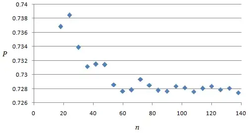

In the following graph, the horizontal axis is $n$, the number of rows in the triangle ($n$ is a multiple of $3$). The vertical axis is $P$, the proportion of numbers that are less than the centre number.
It looks like $P$ is approaching some limit. The rightmost data point is $n=138$ and $P=\frac{7078}{9730}\approx0.72744$. I put $0.72744$ into Wolfram, and it suggested $e^{-1/\pi}\approx 0.72738$.
Is the following conjecture true or false:
Conjecture: In Pascal's triangle with $n$ rows, where $n$ is a multiple of $3$, the proportion of numbers less than the centre number approaches $e^{-1/\pi}$ as $n\to\infty$.

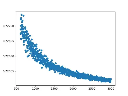

I ran a straight forward python code that calculates the ratio for every $n$ between $1$ and $2998$. The results are given in the following figure, which numerically shows that the limit is smaller than ~$0.72685$, which is smaller than the conjecture's constant $e^{-\pi} = 0.72738$.
The code is as follows:
def calc_pascal_up_to(n_rows): rows = [[1]] d = {} while len(rows) < n_rows: cur_row = [1] + [rows[-1][j] + rows[-1][j + 1] for j in range(len(rows[-1]) - 1)] + [1] rows.append(cur_row) if len(rows) % 3 == 1: center_val = rows[(2 * (len(rows) - 1)) // 3][(len(rows) - 1) // 3] n_entries = len(rows) * (len(rows) + 1) / 2 n_small_entries = sum([len([v for v in row if v < center_val]) for row in rows]) d[len(rows) - 1] = n_small_entries / n_entries return d
d = calc_pascal_up_to(3000)
x = sorted(d.keys()) y = [d[i] for i in x] plt.scatter(x[200:], y[200:]) plt.show()
Edit: Changed the comparison with the centre number to a strict inequality, so it will be consistent with the proportions calculated by Dan. That does not change the asymptotic value or the graph at all.

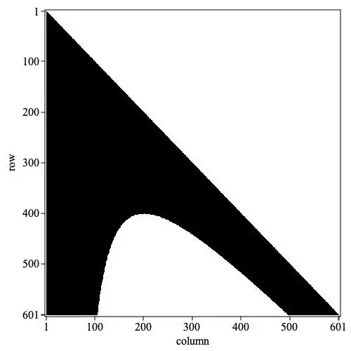

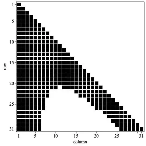

Here are some pictures.
$n=30$
A30
(row numbering begins with $1$)
$n=150$
A150
$n=600$
A600
It looks like it approaches a curve. But what curve? A hyperbola?

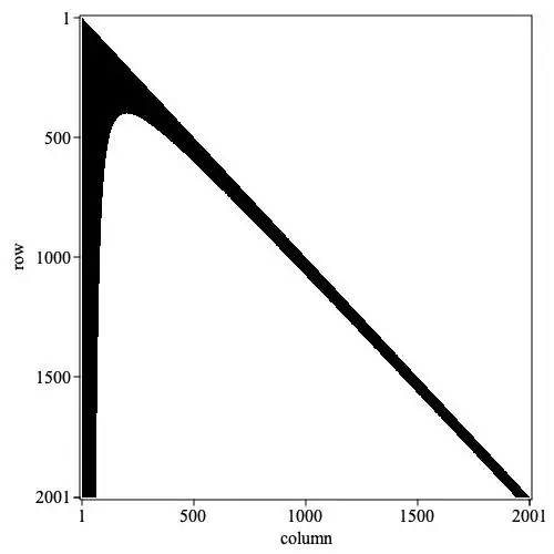

Here I repeated $n=600$, but included extra rows.
A600x
Do you think it is a hyperbola? Something that approaches the asymptotes more slowly?
GEdgar
  • 117,296
  • Beautiful graphs. I don't think it's a hyperbola. Suppose it's a hyperbola, and the triangle is bounded by $y=\pm\sqrt3 x$ and $y=-1.5$. The equation of the hyperbola would be $y=-\sqrt{3x^2+1}$. The area of the region inside the triangle and above the hyperbola, is $\frac34\sqrt3-\int_{-\sqrt{15}/6}^{\sqrt{15}/6}(1.5-\sqrt{3x^2+1})dx\approx0.8864$; the ratio of this to the area of the triangle is about $0.682$, which differs from the calculated proportion $0.726776$. – Dan Nov 28 '23 at 13:37
    The curve is described in my answer.... it's defined implicitly by $g(\mu) \equiv -\mu \log \mu - (1-\mu)\log(1-\mu) = (2\log 2)/(3 \alpha)$, where $\mu = x/y$ and $\alpha = y/N$. Equivalently, $x = y \cdot g^{-1}((2 N \log 2)/(3 y))$ (noting that $g^{-1}$ is two-valued). – mjqxxxx Nov 28 '23 at 17:20
  • It does look an awful lot like a hyperbola to me, just not centered at the tip of the triangle. https://www.desmos.com/calculator/rraaxfsgzf Edit: mjqxxxx's comment didn't show up until after I wrote this. Cool to see there's an exact form! – Polygon Nov 28 '23 at 17:57
  • @Polygon I'm not sure if I'd call it an exact form, since it involves the inverse of $g$. – Rei Henigman Nov 28 '23 at 18:24
    @ReiHenigman True, I guess in my mind an implicit formula was good enough to be called an exact form. – Polygon Nov 28 '23 at 18:29
    @ReiHenigman You can express $x$ and $y$ as explicit functions of $x/y$: e.g., $y = 2N\log 2 / (3 g(x/y))$. So you don't really need to take the inverse. In fact, this must allow an explicit integral representation of the area in terms of $g$ as well. – mjqxxxx Nov 28 '23 at 19:38
