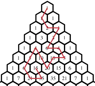

Let's take a random walk on Pascal's triangle, starting at the top. Each number is in a regular hexagon. At each step, we can move to any adjacent hexagon with equal probability, but we cannot revisit a hexagon. The walk ends when we cannot move.
Here is an example in which the final number is $15$.
Does the final number have infinite expectation?

After some step, if we find ourselves in "open territory" (no previously visited hexagons nearby), then there is a sequence of five moves that would end the walk. This is illustrated by this image provided by @Stef in the comments:
(The first red line segment after the blue line segment could have been in any other direction, so we don't count that one.)
The probability of such a sequence would be $\left(\frac{1}{5}\right)\left(\frac{1}{5}\right)\left(\frac{1}{5}\right)\left(\frac{1}{5}\right)\left(\frac{1}{4}\right)=\frac{1}{2500}$. Using the expectation of a geometric distribution, the expected number of steps in a walk would be roughly $2500$. I believe, but am not sure, that the expected row number at the end would be on the order of $\sqrt{2500}=50$. (This rough analysis ignores several factors, for example the effect of the boundaries of the triangle.)

    @GérardLetac Yes; when you reach a new level $n$ for the first time, the probability of doing a "snail pattern" https://i.sstatic.net/8o93I.png that stops on level n+1 a few moves later is at least $\frac{1}{5^4}\frac 1 4 = 0.0004$; so everytime you reach a new level you have probability at least 0.0004 of stopping. – Stef Dec 02 '23 at 13:41
