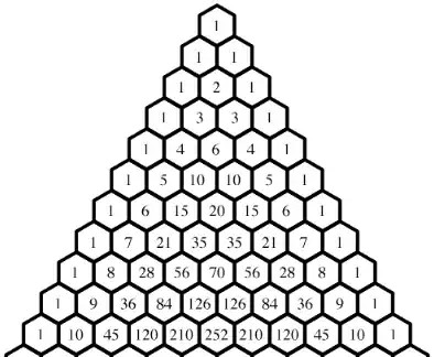

Let $p(k)$ be the $k^\text{th}$ number in Pascal's triangle, numbered from left to right in each row, going down the rows.
So, for example, $p(1)$ to $p(10)$ are $\binom{0}{0},\space \binom{1}{0},\space \binom{1}{1},\space \binom{2}{0},\space \binom{2}{1},\space \binom{2}{2},\space \binom{3}{0},\space \binom{3}{1},\space \binom{3}{2},\space \binom{3}{3}$, respectively.

Here and here is the sequence $p(k)$, except their index is shifted down $1$ from mine. So for example, my $p(5)$ is numbered as the $4$th term is the linked sequence.
Context: I have been playing with Pascal's triangle, investigating some of its mysterious, geometrical and humourous properties.
