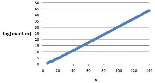

Using Excel, I made a graph of the natural log of the median against $n$, for $n=6$ to $n=140$. (For $n=0$ to $n=5$, the median is $1$.)
I used the points from $n=101$ to $n=140$ to calculate a trendline, and I got $\text{median}\approx 0.126\times1.380^n$ Do the constants have asymptotic closed forms? That $1.380$ is very close to $\ln4\approx1.386$.

  • Could $1.38$ be $2\log 2$? – Gary Nov 20 '23 at 06:43
  • @Gary I wondered that also. To get a better approximation, I would have to use many more rows of Pascal's triangle, but Excel is quite limited. – Dan Nov 20 '23 at 06:47
  • What do you get if you compute the median and divide it with $(2\log 2)^n$? – Gary Nov 20 '23 at 06:50
  • @Gary The graph of $\frac{\text{median}}{(2\log 2)^2}$ against $n$ appears to converge to about $0.09$, but the curve is a bit "bumpy", I guess due to the discrete nature of the binomial coefficients. – Dan Nov 20 '23 at 06:58
