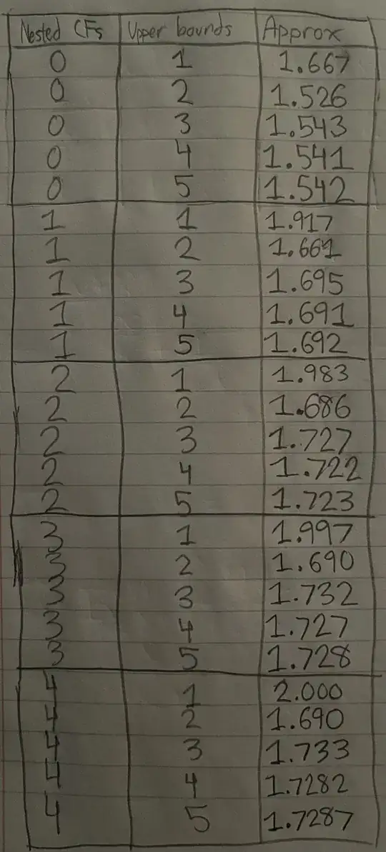

I found a slight simplification of the complicated continued fraction involving nesting infinite CFs into the partial numerator arguments of infinite CFs. Although my solution may be inaccurate, this was a fun attempt to simplify the complicated continued fraction.
I thought it would be interesting to attempt to simplify the complicated continued fraction to a general continued fraction form. In this response, I will use the following generalized CF notation (Gauss Continued Fraction Notation):
$$ \underset{n=x}{\overset{y}{ \mathrm K}} \frac{a_n}{b_n} = \frac{a_x}{b_x + \frac{a_{x+1}}{b_{x+1} + \frac{a_{x+2}}{... b_{y-1} + \frac{a_y}{b_y}}}} $$
Where the numerator of the fraction after the K is the partial numerator argument and the denominator is the partial denominator argument. We will also use the following function:
$$T(x)=x+\frac{x+1+\frac{x+2+\cdots}{x+3+\cdots}}{x+2+\frac{x+3+\cdots}{x+4+\cdots}}$$
To be straight to the point, I found a slightly valid solution to “simplify” T(1) (the complicated continued fraction) in a general CF for all of T(x).
$$T(x)=x+\underset{n_1=1}{\overset{\infty}{ \mathrm K}} \frac{(2n_1-1)+x+\underset{n_2=n_1}{\overset{\infty}{ \mathrm K}} \frac{(2n_2)+x+ \underset{n_3=n_2}{\overset{\infty}{ \mathrm K}} \frac{(2n_3+1)+x+\cdots}{(2n_3+2)+x}}{(2n_2+1)+x}}{(2n_1)+x}$$
Where we infinitely nest CFs in their predecessor’s partial numerator argument. This solution above appears to be valid when expanded, acknowledging the nth Gauss Continued Fraction K Notation has an index equal to the previous CF’s index (where I denoted the current index as $I_n$), a partial numerator argument of $((2I_n-2+n)+x+$the next CF$)$ and a partial denominator argument of $(2I_n-1+n)+x$. The value n is the current continued fraction’s index’s subscript. Thus, setting x equal to 1 in the formula above is a slightly valid solution if this can even be considered a simplification. The table below shows outputs for specific upper bounds of all of the continued fractions and the number of Gauss continued fraction notations of T(1). In other words, it is the outputs of: $$1+\underset{n_1=1}{\overset{N}{ \mathrm K}} \frac{(2n_1-1)+1+\underset{n_2=n_1}{\overset{N}{ \mathrm K}} \frac{(2n_2)+1+\cdots \underset{n_y=n_{y-1}}{\overset{N}{ \mathrm K}} +\frac{2n_y-1+y}{2n_y+y} }{(2n_2+1)+1}}{(2n_1)+1} $$ Note that N represent Upper Bounds on the table, y represents the nested CFs, and the approximated outputs are represented by approx on the table. The CF above may be formatted weirdly on some devices as well. This will lead to an image of a table of values for the Gauss Continued Fraction formula of T(1).
As one can probably see, as N and y increase, their output seems to be around 1.73. It appears that when N is equal to y and both values are large, they seem to converge to about 1.729. Although, I have no proof yet that the CF above even converges when the bounds approach infinity. Overall, this was a fun and interesting problem and I hope the “solution” above can be modified further to produce great solutions.

  • What are $n_1,n_2$ etc ? the only variable in $T(x)$ is $x$ ? – mick Sep 02 '24 at 18:53
  • $n_1$, $n_2$, et cetera are the indices of the Gauss continued fraction K’s (ContinuedFractionK in Wolfram Alpha) – Andre Bhat. Sep 03 '24 at 03:21
  • You write $n_1 = 1$ and later $n_2 = n_1$ and then $...$ So they are all $1$ ? I do not understand what you mean by " indices of the gauss continued fractions K and I bet I am not alone. So if the indexes all start at $1$ then they are all $1$ ?? * Confused * – mick Sep 03 '24 at 20:00
  • No because the each index increases by 1 each iteration to approach the upper bound. For example: $\underset{n=1}{\overset{2}{K}}\frac{1}{n}=\frac{1}{1+\frac{1}{2}}$ You can probably see the next denominator increases by 1 because it is equivalent to the index which increases by 1 each iteration to reach the final iteration which has the index equal to 2. It works in the same way for the nested continued fractions in the denominators of continued fractions by setting their index equal to the index of the CF iteration they are currently in. I can give a deeper explanation if you want. – Andre Bhat. Sep 04 '24 at 00:19
    It’s like sum notation indices or product notation indices that increase with each iteration by 1 until the index reaches the upper bound. – Andre Bhat. Sep 04 '24 at 00:30
  • @AndreBhat. ah ok, I think I got it. Thanks. – mick Sep 04 '24 at 21:46
