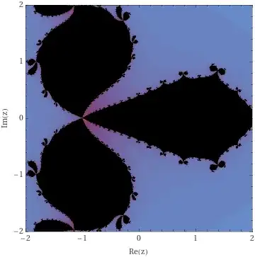

I found $2$ results.
$$z - \frac{(z^3 - 2)(z+1)}{10}$$
for decimal and
$$z - \frac{(z^3 - 2)(z+1)}{16}$$
for hexadecimal.
In fact they can be ajusted to the base you want to use.
For bases larger than $6$ :
$$z - \frac{(z^3 - 2)(z+1)}{a}$$
for base $a$.
They clearly fail for starting point at $-1$ but for real numbers between $\frac{-3}{4}$ and $2$ they usually work.
the julia set picture :
Julia set for the decimal case
