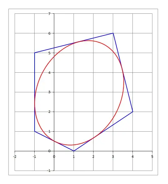

Using the methods of projective geometry, identify the unique ellipse that is inscribed in a given convex pentagon.
Suppose the vertices of the pentagon are: $(1, 0), (4, 2), (3, 6), (-1, 5), (-1, 1)$. Find the equation of the unique inscribed ellipse that is tangent to all five sides of this convex pentagon.

  • The way I solved this problem was the direct approach, where I specified the unknown ellipse using it equation $(r - C)^T Q (r - C) = 1 $, then iteratively found $Q$ and $C$ using the constraints of tangency on the five sides of the pentagon. –  Aug 25 '22 at 06:26

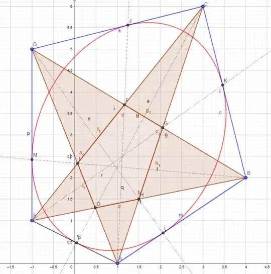

Idea - see picture. Find five points - lines with points intersection of diagonals and $A,B,C,D,E$ give tangent points. Answer: $$\frac{-435}{764}x^2+\frac{75}{382}xy-\frac{3481}{8404}y^2+\frac{165}{191} x+\frac{421}{191}y-1=0$$

  • What justifies this construction ? – Jean Marie Mar 17 '23 at 15:45
    @JeanMarie Brianchon'sTheorem. If $ABCDE$ is a convex pentagon and $F$ is the point of tangency of the inscribed ellipse on $\overline{AE}$, then $ABCDEF$ acts as a hexagon to which the theorem is applied. Thereby $F$ must be collinear with $C$ and the intersection of $\overline{AD}$ with $\overline{BE}$. The entire diagram is obtained by this method with cyclically permuting the labels $A$ through $E$. – Oscar Lanzi May 20 '23 at 01:21
  • @Oscar Lanzi Thank you very much. It's very clear now ! – Jean Marie May 20 '23 at 05:34
