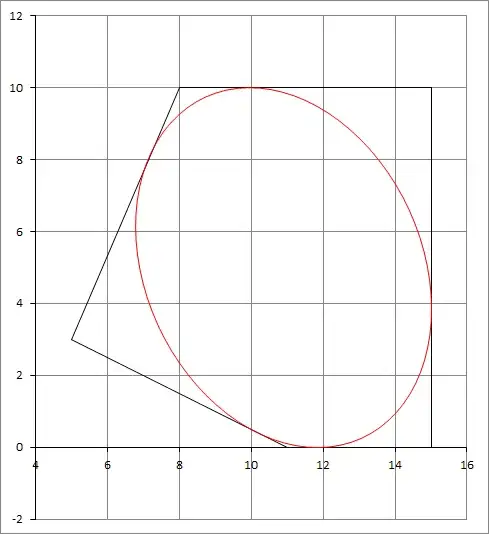

Question: Given the five vertices of a convex pentagon, determine the ellipse that is tangent to the sides of this pentagon.
For example, if the five vertices are: $P_1 (11,0) \ , P_2(15,0) \ , P_3 (15,10) \ , P_4 (8, 10) \ , P_5 (5, 3) $, determine the center of the ellipse, the lengths of the semi-major and semi-minor axes, and the angle that the major axis makes with the positive $x$-axis.

Applying the above method to the given pentagon, gives
$ \text{Semi-major axis} = a = 5.209482 $
$ \text{Semi-minor axis} = b = 3.830313 $
$ \text{Angle that major axis makes with positive } x \text{ axis} = \theta = 1.997836 = 114.4676^\circ$
$\text{Center of ellipse} = (10.9, 5) $
Finally the inscribed ellipse is plotted with the given pentagon. This is shown below.
