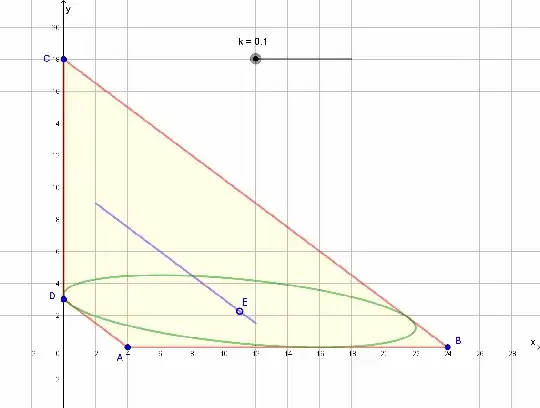

  • Construct a family of conics touching with the axes with parameter $k$:
$$ \left[ k\left( \frac{x}{a}+\frac{y}{c} \right)+ (1-k)\left( \frac{x}{b}+\frac{y}{d} \right)-1 \right]^2=\lambda x y \tag{$\star$} $$
  • Using a discriminant to check tangency for $\frac{x}{a}+\frac{y}{d}=1$ or $\frac{x}{b}+\frac{y}{c}=1$, we can solve for $\lambda$.
$$\lambda=4k(1-k) \left( \frac{1}{a}-\frac{1}{b} \right) \left( \frac{1}{d}-\frac{1}{c} \right)$$
  • For ellipse,
$$4k(1-k) \left( \frac{1}{a}-\dfrac{1}{b} \right) \left( \frac{1}{d}-\dfrac{1}{c} \right) \left( \frac{k}{ac}+\frac{1-k}{bd} \right)>0 \implies k\in (0,1) $$

  • An illustration of a tangential quadrilateral. Note on the circular case at $k=0.6$:

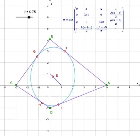

  • To generalize to any kind of convex quadrilateral, we may use the skew axes as the diagonals. Now taking the vertices as $A(a,0)$, $B(0,b)$, $C(c,0)$ and $D(0,d)$ where $ac<0$ and $bd<0$.

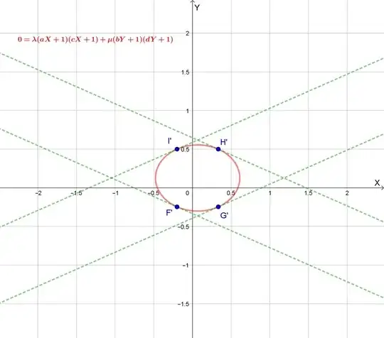

  • In tangential coordinates $(X,Y)$, tangent line $\frac{x}{a}+\frac{y}{b}=1$ can be written as $$Xx+Yy+1=0$$
  • Hence, the dual conic will pass through a "rectangle" with vectices $(-\frac{1}{a},-\frac{1}{b})$, $(-\frac{1}{c},-\frac{1}{b})$, $(-\frac{1}{c},-\frac{1}{d})$ and $(-\frac{1}{a},-\frac{1}{d})$, that is
$$\lambda (aX+1)(cX+1)+\mu (bY+1)(dY+1)=0$$
  • Let $(\lambda,\mu) \propto (1-k,k)$, the inscribed ellipse is
$$\det \begin{pmatrix} 0 & x & y & 1 \\ x & \lambda ac & 0 & \frac{\lambda (a+c)}{2} \\ y & 0 & \mu bd & \frac{\mu (b+d)}{2} \\ 1 &\frac{\lambda (a+c)}{2} & \frac{\mu (b+d)}{2} & \lambda+\mu \end{pmatrix}=0$$
  • The centre divides the Newton line, from $(0, \frac{b+d}{2})$ to $(\frac{a+c}{2},0)$ internally with ratio $\lambda:\mu$
  • Illustration of dual conics pair:

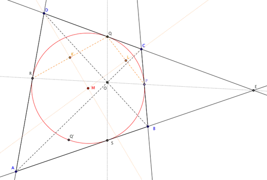

As explained in this answer, once you choose one of the tangency points the other three can be uniquely constructed from the properties of the perspective transformation carrying the quadrilateral to a square.
If you want, in particular, the ellipse corresponding to the circle inscribed into the square, then the construction is very simple (see figure below): join the intersection point $O$ of the diagonals with the concurrence points $E$, $F$ of the opposite sides: lines $EO$ and $FO$ intersect the sides of quadrilateral $ABCD$ at tangency points $PQRS$.
One can then find the centre $M$ of the ellipse as the intersection of lines $DK$, $CL$, where $K$, $L$ are the midpoints of $QR$, $PQ$. If you need to find the equation of the ellipse, you can construct a fifth point $Q'$ as the reflection of $Q$ about $M$. Otherwise, you can use geometric techniques to find axes and foci.
  • That is a very straightforward method. Can you explain why joining O with E and F gives the tangent points? – Msegade Feb 16 '22 at 15:02
    @Msegade It's all explained in the linked answer: a circle inscribed into a square is tangent at the midpoints of the sides. A line through one of these midpoints, parallel to the other sides, intersects the diagonals of the square at their intersection point $O$. But parallel lines become concurring after a perspective transformation, whence the above construction. – Intelligenti pauca Feb 16 '22 at 15:16
    @Msegade In other words: in the square line $POR$ is parallel to $CD$ and $AB$, hence in the transformed quadrilateral the same lines are concurrent. Ditto for line $QOS$ with $BC$ and $AD$. – Intelligenti pauca Feb 16 '22 at 15:49
