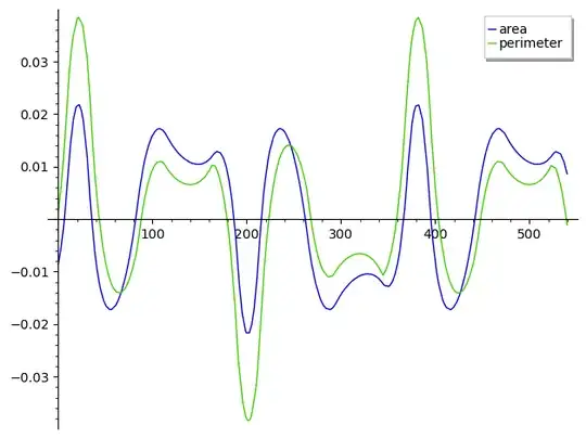

Looking at your “and/or” wording I realize that you might also be interested in a line which cuts both perimeter and area in half at the same time. And there it might be conceivable that the center of the inscribed ellipse plays a relevant role. So let's just use the fairly arbitrary pentagon I define below (scroll down for actual coordinates), and look at that.
Plot of excess area and perimeter given angle of diameter
The $x$ axis of this plot has the angle of the diameter line, in degrees. You will notice a $360°$ periodicity, and you will also notice that after $180°$ you get the same shape flipped. The vertical axis is ratio of area or perimeter on the one side of the line divided by total area or perimeter, minus $\frac12$. So it is the excess over the exact half, in units of ratio of the total. A zero in the graph means equal area or perimeter in both halfs, for that specific angle.
As you can easily see, the two different lines in the plot don't cross the $x$ axis in the same points. They are not zero for the same angle. You don't get a line which cuts both perimeter and angle in half at the same time.
