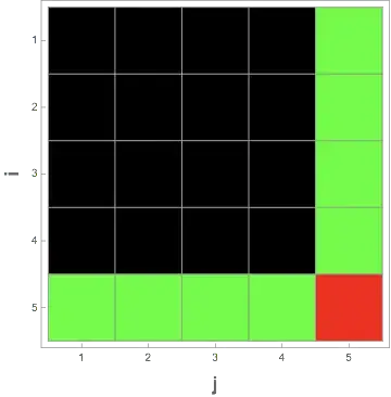

Don't use Venn. Consider instead this table:
If you're in the red, what is the probability you're in the green (overlapping red) region?
Clear?
  • Why is 1 to 5 all green? for a first and second toss? –  Aug 16 '21 at 13:03
  • A 5 on the first toss (i) or a 5 on the second toss (j). – David G. Stork Aug 16 '21 at 16:07
    Oh. Isn't it all green because those are all the combinations that have a 5 in it? (i.e., 1 5, 5 1, 2 5, etc.? And 5 is red because that is the situation where the tosses are 5 5? –  Aug 16 '21 at 16:15
  • The green are where there is a 5 on EITHER the first toss OR the second toss. The red is where the is a 5 on BOTH the first toss AND the second toss. Clear? – David G. Stork Aug 16 '21 at 16:17
    Yes. I believe that is what I said but I said it slightly more unclear? lol –  Aug 16 '21 at 16:18
