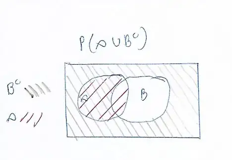

You can make a venn-diagramm.
If we now intersect this the marked area with $B$ then we obtain $A\cap B$.
Therefore $P((A\cup B^c)\cap B)=P(A\cap B)\stackrel{\textrm{ind.}}{=}P(A)\cdot P(B)$
