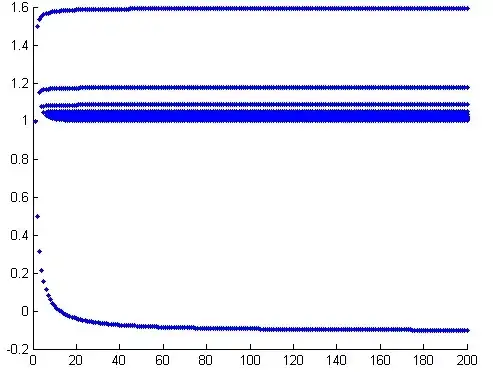

  • I realize that simulations don't give always good hints. 2) In fact, one can start from $N=13$ where the smallest eigenvalue is $-0.004$.
  • – Jean Marie Feb 26 '20 at 08:58
    @JeanMarie Yes, the simulations work poorly when counterexamples are in "corners". –  Feb 26 '20 at 09:01
    An odd fact : on an experimental, basis, vector $V$ with coordinates $V_k=k/(1+k^2)$ is a very good approximation of the eigenvector associated to the first (negative) eigenvalue. – Jean Marie Feb 26 '20 at 09:40
