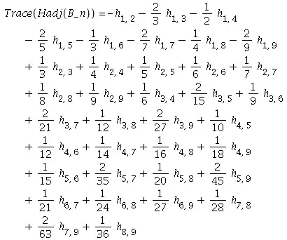

$\textbf{Proof}$. Let $Z_n=\{H\in S_n;h_{i,i}=0,h_{1,j}\leq 0 \text{ for }j>1,h(i,j)\geq 0\text{ for }1<i<j\}$ and $adj(B_n)$ be the adjugate of $B_n$. It suffices to show that, for every $H\in Z_n$, $tr(Hadj(B_n))\geq 0$ and $tr(Hadj(B_n))=0$ implies that $H=0$.
Note that all entries of $U=adj(B_n)$ are positive except the $\{U_{1,j}=U_{j,1};j>1\}$ that are $<0$.
Then, to deduce the required result, it suffices to read the development of $tr(Hadj(B_n))$. For example, when $n=9$,
$\square$
