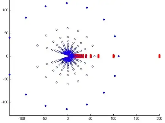

Addendum (November 22, 2018) : Here is a second figure that provides a "bigger" view, with $n=20$ and $0.005 \leq t \leq 0.995$. The eigenvalues corresponding
  • to $t=0.005$ are grouped into the rightmost big red blob on the right,
  • to $t=0.995$ are blue filled dots (quasi-circle with radius $\approx 110$).

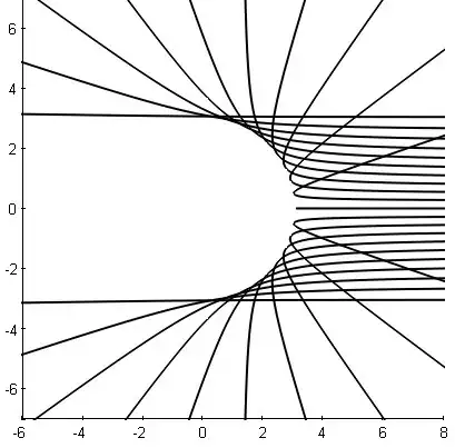

Figure 2 : [enlarged version of Fig. 1 ; case $n=15$] Everything happens as if a planar wave enters at $t=0$ from the right, is slowed down by nucleus' repulsion, then scattered as a circular wave...

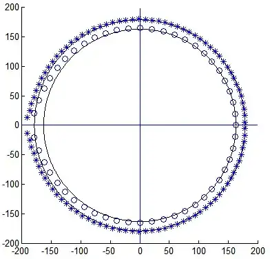

Fig. 3 : Two cases are gathered here, both for $t=0.995$ : $n=51$ (empty circles) and $n=100$ (stars). One can note that the eigenvalues are very close to the $(n+1)$-th roots of unity. For this value of $t$, the radii are given by experimental formula : $R_n=200(1-12.4/n+212/n^2-3110/n^3)$.

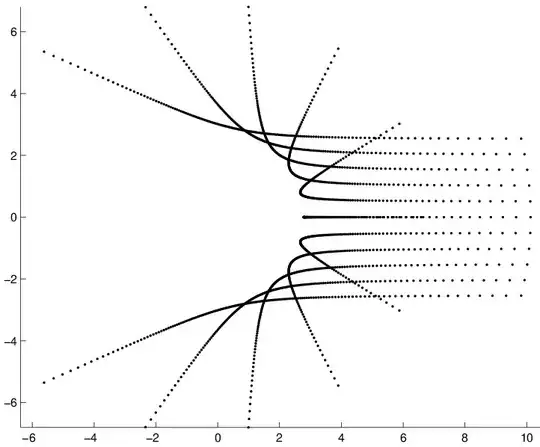

Figure 4 displays a reconstruction result that takes into account the fact that (n+1)th roots of unity give asymptotic directions.
Figure 4 : Case $n=201$. An approximate reconstruction of $21$ among the $n$ trajectories (Matlab program below ; polar equation - adapted from (1) can be seen on line 5). Please note the "ad hoc" coefficient $3.0592$...
 n=201;
 for k=1:20:n
    d=pi*k/(2*(n+1));c=cos(d);
    t=-d+0.01:0.01:d-0.01;
    r=3.0592*(1-c)*exp(i*(t-d))./(cos(t)-c);
    plot(r);plot(conj(r));
 end;
