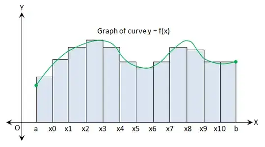

Next we come to the concept of a Riemann sum. Let $P=\{x_0,x_1,\dots,x_n\} $ be a partition of $[a, b] $. A Riemann sum for function $f$ over partition $P$ is a sum of the form $$S(P, f) =\sum_{k=1}^{n}f(t_k)(x_k-x_{k-1})$$ where $t_k\in[x_{k-1},x_k]$. The points $t_k$ are called tags and their choice is totally arbitrary. Thus a Riemann sum depends on the partition as well as the tags. The following image shows how a Riemann sum approximates the area under graph of a function :
Approximation of area via Riemann sum
The points where the green curve intersects the top edge of various rectangles correspond to tags $t_k$ so that function values at tags control the height of the rectangles. The points of partition control the number and width of the rectangles and the Riemann sum represents the total area of these rectangles.
To summarize, in order to form a Riemann sum for a bounded function $f:[a, b] \to\mathbb {R} $ on interval $[a, b] $ we first need to choose a specific partition $P$ of $[a, b] $ and then choose specific tags for this already chosen partition and then form a sum as defined earlier.
A typical example of a partition is uniform partition where the sub-intervals are of equal length and the points of partition are in arithmetic progression $$x_{k} =a+k\cdot\frac{b-a} {n} $$ and here the norm $||P||=(b-a) /n$. If we choose the left end point of each sub-interval as tag so that $t_k=x_{k-1}$ we get the left Riemann sum for this partition $$\sum_{k=1}^{n}f\left(a+(k-1)\cdot\frac{b-a}{n}\right)\cdot\frac {b-a} {n} =\frac{b-a} {n} \sum_{k=0}^{n-1}f\left(a+k\cdot\frac{b-a}{n}\right)$$ If we choose right end point of each sub-interval as tag so that $t_k=x_k$ we get the right Riemann sum for this partition $$\frac{b-a}{n} \sum_{k=1}^{n}f\left(a+k\cdot\frac{b-a}{n}\right)$$
