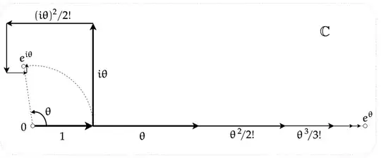

In the next geometric approach I will appeal to euler's formulas which is explored in detail by Needham (1997).
By re-expressing $e^{i \theta}$ as a power series $e^{x} = 1 + x +\frac{x^2}{2!}+\frac{x^3}{3!}+\cdots$, we have:
$$e^{i \theta} = 1 + (i \theta) +\frac{(i \theta)^2}{2!}+\frac{(i \theta)^3}{3!}+\cdots$$
$$e^{i \theta} = 1 + i \theta -\frac{\theta^2}{2!}-\frac{i \theta^3}{3!}+\cdots$$
"This series is just as meaningful as the series for $e^x$, but instead of the terms all having the same direction, here each term makes a right angle with the previous one, producing a kind of spiral." (Needham, 1997)

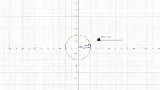

If we visualize complex numbers as vectors then we are adding these real vectors and imaginary vectors that gets smaller at every term of the power series.
Let's strive for an intuitive geometric insight, and then formalize it:
What might not be obvious is that the path it takes as theta changes is actually a circle.
So, we must show two things:
  1. The sum of the vectors have a lenght of 1
  2. The angle formed by the sum of this vectors is $\theta$.
Then, by splitting real and imaginary parts we get:
$$C(\theta)=1-\frac{\theta^2}{2!}+\frac{\theta^4}{4!}-\cdots$$
$$S(\theta)=\theta-\frac{\theta^3}{3!}+\frac{\theta^5}{5!}-\cdots$$
Thus, $e^{i\theta}=C(\theta)+iS(\theta)$.
By using Taylor series, we have that these are the polinomial expansion of cosine and sine of theta.
Thus, $e^{i\theta}=cos(\theta)+isin(\theta)$.
This approach demonstrates that the path they form is a circle with radius 1.
