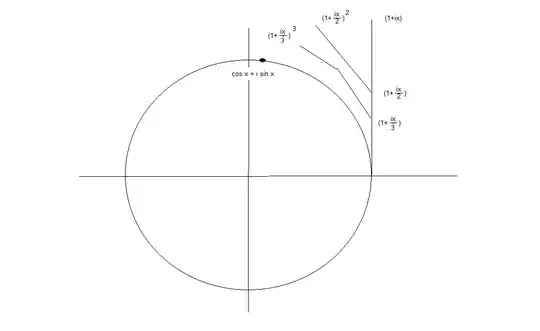

we can define $e = \lim_\limits{n\to\infty}(1+\frac {1}{n})^n\\ e^x =\lim_\limits{n\to\infty} (1+\frac {1}{n})^{nx} $
Make a substitution $m = nx$
$e^x =\lim_\limits{m\to\infty} (1+\frac {x}{m})^m $
Then look at what happens as $m = 1, 2,3, etc.$
We have already shown that multiplication of complex numbers multiplies the lengths and adds the angles.
As $m$ increases hopefully you can see how that sequence of line segments begins to lie on the curve of the circle.
and when $m$ is very large comes to rest on $\cos x + i\sin x$
