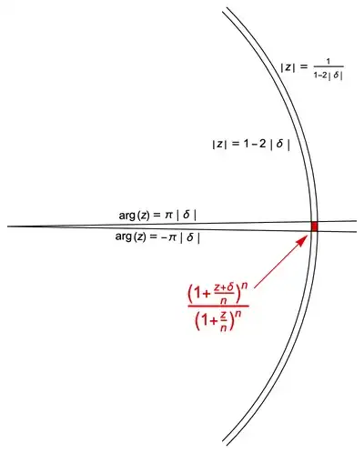

Using the methods from this answer, we show the following: $$ \begin{align} \left|\frac{\left(1+\frac{z}n\right)^n}{\left(1+\frac{z+\delta}n\right)^n}\right| &=\left|\,1-\frac\delta{n+z+\delta}\,\right|^n\tag{1a}\\ &\ge\left(1-\frac{|\delta|}{n-|z+\delta|}\right)^n\tag{1b}\\[3pt] &\ge1-\frac{n\,|\delta|}{n-|z+\delta|}\tag{1c} \end{align} $$ Explanation:
$\text{(1a)}$: distribute the exponent over the quotient
$\phantom{\text{(1a): }}$simplify the quotient
$\text{(1b)}$: triangle inequality (twice)
$\text{(1c)}$: Bernoulli's Inequality $$ \begin{align} \left|\frac{\left(1+\frac{z+\delta}n\right)^n}{\left(1+\frac{z}n\right)^n}\right| &=\left|\,1+\frac\delta{n+z}\,\right|^n\tag{2a}\\ &\ge\left(1-\frac{|\delta|}{n-|z|}\right)^n\tag{2b}\\[3pt] &\ge1-\frac{n\,|\delta|}{n-|z|}\tag{2c} \end{align} $$ Explanation:
$\text{(2a)}$: distribute the exponent over the quotient
$\phantom{\text{(2a): }}$simplify the quotient
$\text{(2b)}$: triangle inequality (twice)
$\text{(2c)}$: Bernoulli's Inequality
Therefore, $$ 1-\frac{n\,|\delta|}{n-|z|}\le\left|\frac{\left(1+\frac{z+\delta}n\right)^n}{\left(1+\frac{z}n\right)^n}\right|\le\frac1{1-\frac{n\,|\delta|}{n-|z+\delta|}}\tag3 $$ Furthermore, $$ \begin{align} \left|\,\arg\left(\frac{\left(1+\frac{z+\delta}n\right)^n}{\left(1+\frac{z}n\right)^n}\right)\,\right| &=n\left|\,\arg\left(\frac{1+\frac{z+\delta}n}{1+\frac{z}n}\right)\,\right|\tag{4a}\\ &=n\left|\,\arg\left(1+\frac{\delta}{n+z}\right)\,\right|\tag{4b}\\[3pt] &\le n\sin^{-1}\left(\frac{|\delta|}{|n+z|}\right)\tag{4c}\\[3pt] &\le\frac\pi2\frac{n\,|\delta|}{n-|z|}\tag{4d} \end{align} $$ Explanation:
$\text{(4a)}$: distribute the exponent
$\phantom{\text{(4a): }}$$\arg\left(z^n\right)=n\arg(z)$
$\text{(4b)}$: simplify the quotient
$\text{(4c)}$: $|\arg(1+z)|\le\sin^{-1}(|z|)$
$\text{(4d)}$: $\sin^{-1}(x)\le\frac\pi2x$ for $0\le x\le1$
$\phantom{\text{(4d):}}$ triangle inequality
For $|\delta|\lt\frac12$ and $n\ge2|z|+1$, $(3)$ gives the thin annulus $$ 1-2|\delta|\le\left|\frac{\left(1+\frac{z+\delta}n\right)^n}{\left(1+\frac{z}n\right)^n}\right|\le\frac1{1-2|\delta|}\tag5 $$ and $(4)$ gives the thin sector $$ \left|\,\arg\left(\frac{\left(1+\frac{z+\delta}n\right)^n}{\left(1+\frac{z}n\right)^n}\right)\,\right|\le\pi|\delta|\tag6 $$ As $\delta\to0$, the intersection of the annulus and the sector tend to $1$: enter image description here

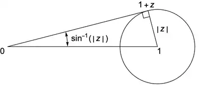

Concerning $\bf{(4c)}$
In the justification of $\text{(4c)}$, it is claimed that $$ |\arg(1+z)|\le\sin^{-1}(|z|)\tag7 $$ As illustrated below, the maximum of $\arg(1+z)$ is attained on the tangent to the circle of radius $|z|$ centered at $1$. In that arrangement, $\arg(1+z)=\sin^{-1}(|z|)$. Symmetry gives $(7)$.
