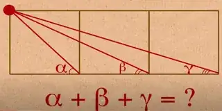

So I was watching an "old" video from Numberphile, "The Three Square Geometry Problem". Here is a screenshot:
It's pretty easy to see that the sum of three angles is 90°, but now I am curious: What if we keep going on? What if we had more than 3 squares and with that more than 3 angles? What would the sum be?
Basically I want to find the value of: $$\lim\limits_{n \rightarrow \infty}\sum\limits_{k=1}^n \arctan\left(\frac{1}{\sqrt{k^2+1}}\right)$$
If there is an answer I would like to know it. Thank you.
P.S. $\arctan$ stands for $\tan^{-1}$

  • Please give a summary of the relevant information from the video in your post. You can't expect people to watch a 12-minute youTube clip in order to understand your question. – John Gowers Jun 20 '15 at 19:25
    As it relates to generalizing the three-square problem, it should really just be $1/k$ inside the arctan, not $1/\sqrt{k^2+1}$. (Note, there is a link to the question here from https://math.stackexchange.com/questions/2800600/extended-3square-problem .) – Barry Cipra May 29 '18 at 20:31
