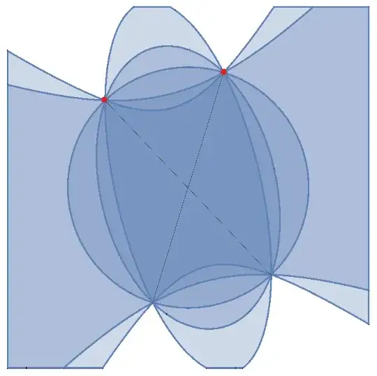

Here is example of 2D situation: describing two points as intersection of ellipses/hyperbolas. Intersection only adds symmetric ($-x$) points, the question is when it is true, also in higher dimensions: enter image description here
