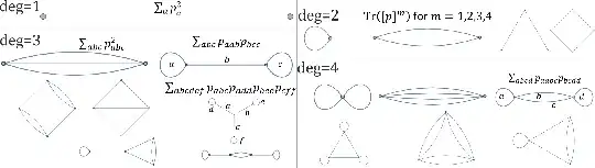

Update 4: Diagrammatic representation of some first rotation invariants for degree 1,2,3,4:
Degree of polynomial is also degree of vertex. Edge corresponds to summed index. Vertices and edges are unlabeled. Disconnected graphs gives invariants being products over its components.
