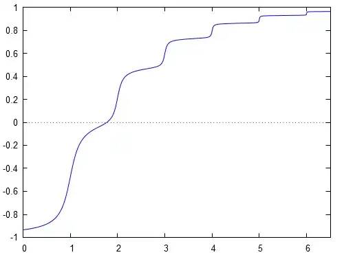

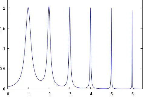

15
Because all counterxamples given here are oscillating, perhaps someone might wonder whether the proposition is true if we require the funcion to be monotonic. The answer is still no. Simply consider the inverse of the function, monotonic on $(0,\infty)$, given here $f(x)=\frac{1}{x}+\sin\left(\frac{1}{x}\right)$.
Also: consider the cumulative distribution function corresponding to a probability density function that has no limit as $x\to +\infty$. For example, the integral of the density constructed here. Or, using the same idea with a Cauchy distribution we get other example:
$$F(x)= \frac{2}{\pi}\sum_{k=1}^\infty \frac{\tan^{-1}\left((x-k) \pi 2^k\right)}{2^k} $$
This tends to $1$, but its derivative $f(x)=F'(x)= 2 \sum_{k=1}^\infty (\pi^2 2^{2k} (x-k)^2 +1)^{-1} $ has no limit, because $f(n)>2$ $\forall n \in \mathbb{N}$.
