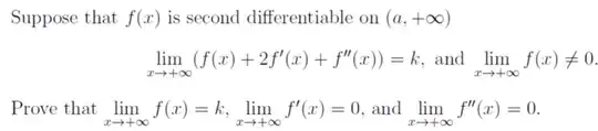

How to do this question?
Tried separating the limit to
$$\lim_{x \rightarrow +\infty} f(x) + 2 \lim_{x \rightarrow +\infty} f'(x) + \lim_{x \rightarrow +\infty} f"(x) = k$$
but seems not working

Let $$F(x)=e^xf(x)\quad\text{and}\quad G(x)=e^x.$$The hypothesis rewrites$$\lim_{+\infty}\frac{F''}{G''}=k.$$By L'Hôpital's rule (used twice), this implies $$\lim_{+\infty}\frac{F'}{G'}=k\quad\text{and}\quad\lim_{+\infty}\frac FG=k,$$i.e. $\lim_{+\infty}(f+f')=k$ and $\lim_{+\infty}f=k$, whence the claim. Note that the hypothesis of non-nullity of $\lim_{+\infty}f$, nor even of its existence, was useless.

    That's really cool! – RT1 Oct 04 '22 at 12:44
    But $\lim_{\infty} f(x)\neq 0$ for $\frac{\infty}{\infty}$. I saw this trick somewhere. – Bob Dobbs Oct 04 '22 at 13:23
  • $\infty\times 0=c$ isnt it? – Bob Dobbs Oct 04 '22 at 13:45
  • @AnneBauval I don't follow the logic. The first step is taking $F(x) = e^{x} f(x)$ and $G(x)=e^{x}$. What is the reason and doesn't it mean the prove only works for certain case (not general case)? – Magenta Oct 05 '22 at 00:37
    @AnneBauval Now I see the logic behind it, $F(x)/G(x)$ will be $f(x)$ and this would be general case. Your idea is brilliant. Thank you – Magenta Oct 05 '22 at 04:15
  • How do I know that $\lim F'(x)=\infty$ to use L'Hospital's rule ? – Ivan Kaznacheyeu Oct 05 '22 at 12:46
    @Ivan Kaznacheyeu This hypothesis in L'Hospital's rule is in fact unnecessary. See e.g. the comments in https://en.wikipedia.org/wiki/L%27H%C3%B4pital%27s_rule#General_form – Anne Bauval Oct 05 '22 at 12:49

We first prove this lemma:
Lemma: let h be a differentiable function in $(a,\infty)$ such that $\lim_{x \rightarrow +\infty} h(x) + h^{'}(x) =k$ thus $\lim_{x \rightarrow +\infty} h(x) = k$ and $\lim_{x \rightarrow +\infty} h^{'}(x) = 0$.
It's enough to prove that $\lim_{x \to \infty}h(x)=k$.
Let $\epsilon > 0$ let's assume by contradiction that for all $N>0$ there exit $x>N$ such that $h(x) > k + \epsilon$. because $\lim_{x \to +\infty} h(x) + h^{'}(x) =k$ there exist $M>0$ such that for all $x>M$ we have $k-\frac{\epsilon}{2} < h(x)+h^{'}(x) < k-\frac{\epsilon}{2}$.
Notice that there exist $y>M$ such that $h(y) <k + \epsilon$ otherwise for all $y>M$ $h^{'}(y)\le k-\frac{\epsilon}{2} - h(y) \le k-\frac{\epsilon}{2} -(k + \epsilon)= -\frac{\epsilon}{2}$. and thus $\lim_{y \to \infty} f(y) = -\infty$ (from Lagrange).
So let $y>M$ such that $h(y) < k+ \epsilon$ from the assumption there exist $x>y$ such that $h(x) > k +\epsilon$. From continuity of $h$ there exist $a \in (y,x)$ such that $h(a) = k + \epsilon$. Define $z = \sup\{b\in (y,x) | h(b) =k+ \epsilon\}$ notice that z is well defined as $a \in \{b\in (y,x) | h(b) =k+ \epsilon\}$. Also from continuity $h(z)=k + \epsilon$ and $z<x$. And finally notice that for every $c \in (z,x)$ $h(c) > k +\epsilon$(otherwise there will be a point $p$ between $(z,x)$ such that $h(p)=k + \epsilon$ in contradiction to that that $z$ is the supremum.
notice that $h(x)>h(z)$ and thus from Lagrange there exist a point $b \in (z,x)$ such that $h'(b) > 0$. But this is a contradiction as for every point $c \in (z,x)$ $h^{'}(c)\le k-\frac{\epsilon}{2} - h(c) \le k-\frac{\epsilon}{2} -(k + \epsilon)= -\frac{\epsilon}{2}<0$
And thus there exist $N_1>0$ such that for every $x>N_1$ we have $h(x) \le k+ \epsilon$. In the same way we can prove that there exist $N_2>0$ such that for every $x>N_2$ we have $h(x) \ge k - \epsilon$. And thus for $N = \max\{N_1,N_2\}$ for all $x > N$ we have $|h(x) -k| \le \epsilon$.
And thus $\lim_{x \to \infty}h(x)=k$. So we get the lemma.
Now define $h(x) = f(x) +f^{'}(x)$. Thus the assumption in the question tells us that $\lim_{x \rightarrow +\infty} h(x) + h^{'}(x) =k$. And thus from the lemma we get that $\lim_{x \rightarrow +\infty} h(x) = k$ and $\lim_{x \rightarrow +\infty} h^{'}(x) = 0$.
Now $k = \lim_{x \rightarrow +\infty} h(x) = \lim_{x \rightarrow +\infty} f(x) + f'(x)$. And again from the lemma we get that $\lim_{x \rightarrow +\infty} f(x) = k$ and $\lim_{x \rightarrow +\infty} f^{'}(x) = 0$.
And now from limit arithmetic we can get that $\lim_{x \rightarrow +\infty} f^{''}(x) = \lim_{x \rightarrow +\infty} (f^{''}(x) +2f^{'}(x)+f(x))-2f^{'}(x)-f(x)=k+2\cdot 0 - k = 0$
