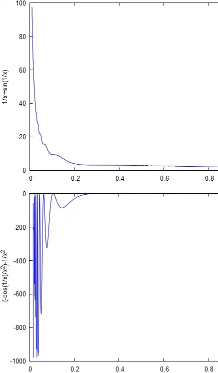

50
if a graph has vertical asymptote, the derivative must also have a vertical asymptote too, right?
No. A counterexample: $$f(x)=\frac{1}{x}+\sin\left(\frac{1}{x}\right)$$ This function is monotone and has a vertical asymptote at $x=0$. But its derivative has no limit.
leonbloy
  • 66,202
