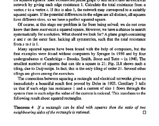

I believe there is also a proof by associating the tiling with an electric network!
This is a section in the book "Modern Graph Theory" by Béla Bollobás.
It is titled "Squaring the Square" and is numbered section II.2. See this: http://books.google.com/books?id=SbZKSZ-1qrwC&pg=PA46.
A snapshot of the page which talks about Dehn's theorem and it's proof (also found here: http://books.google.com/books?id=SbZKSZ-1qrwC&pg=PA48):
alt text
Note, even though the section starts off talking about the tiling squares being of distinct lengths, the proof of Dehn's theorem (and the problem you seek) is essentially there.
