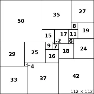

The classic problem of constructing a perfect squared square, i.e. tiling a square with a finite number of squares of pairwise distinct sidelengths (which must be rational multiples of the tiled square's, so we need only look for integral tilings) has solutions (one is shown below). However, it has been proved impossible to tile an equilateral triangle with equilateral triangles of distinct sizes (elegant proof here). It is also impossible to do it for other (more-sided) regular polygons since the angle between a corner piece and the side of the tiled polygon will be acute.

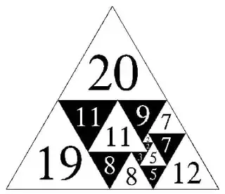

It is possible however to tile an equilateral triangle with equilateral triangles which can have the same size if their orientation is different; an example is shown below. It is worth wondering whether such a dissection might be possible for the tetrahedron.

Perfect squared square:
$\hskip2in$Squared square
Equilateral triangle dissection:
$\hskip2in$Triangled triangle
